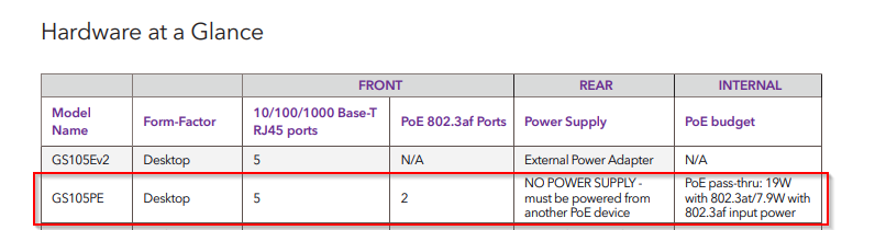

   I would to connect and power my switches this way  main router ->  GS305P or GS305PP  ->   GS105PE  -> GS108T .
I am wondering if I really need PoE+ powering my GS105PE ? I came upon table in forums which indicates that GS105PE can supply power only to Class 1 and 2 devices when powered by simple PoE.
  So the real question is - what PoE class GS108T is reporting to its powering devices? How many watts does it use?
Also similar question: what PoE class GS105PE is reporing to its powering devices? How many watts does it use (when no PoE passthru is active)?

    For GS105PE:
    The PoE pass-thru capacity depend on input power mode.Below is detailed info:

  • schumaku's avatar
    schumaku
    Yes, you do.
    Complete information available -> GS105PE: PoE troubleshooting (strange title - but very informative)
    Most likely Class 0 - as many PoE devices do, even if they require much less max power. GS108Tv2 Datasheet says max 6 W however. Sad Netgear does nor provide the exact specs here.
    Not sure on how they make the spread between the two standards - if they would request a hard Class 4 a 802.3af source would refuse to power it. Calculate about max. 0.8W per GbE port.
