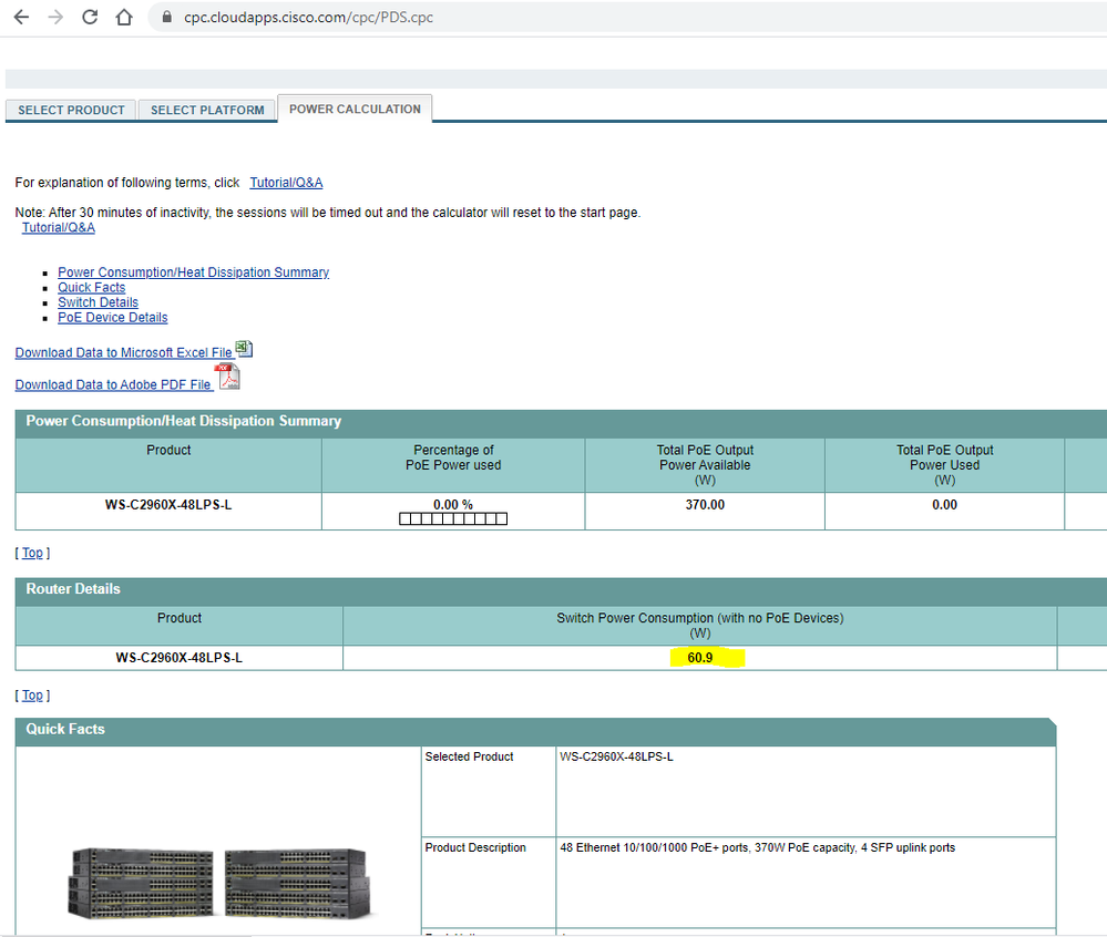

So we Netgear is about in the same range as a Cisco Catalyst 2960X-48 at 100% load (Cisco Catalyst 2960-X and 2960-XR Series Switches Data Sheet, p.29). 100% to 10% load is about 2% less power only, idle 0% load about 24% so I estimate some 46W for your switch model.
When we compare the 600 USD for a GS752TP to the 3000 USD for the Cisco ... this is a good part for you pay for the additional information they provide. So you can burn much more power on the Cisco until the cost are exceeding the hardware 8-)
Oh CPC does show 60.9W FWIW:
