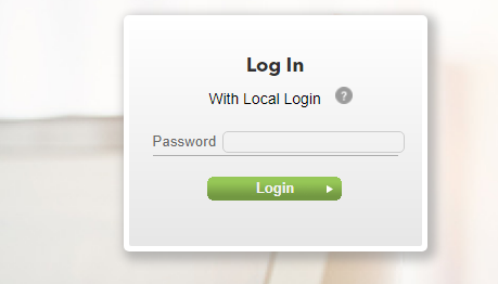

No simple password prompt like this?
If not, they will make a lot of customers unhappy.... IphieChen YeZ Christian_R !

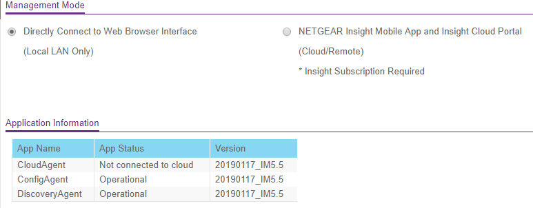

When i setup the switch offline for the first time, i see this:

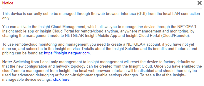

after login, i always get this message
and then the management info:

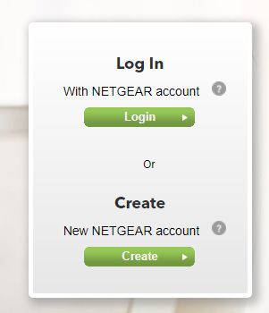

After configuring the switch and putting it on a network with DHCP and internet access, this is what I see to login:

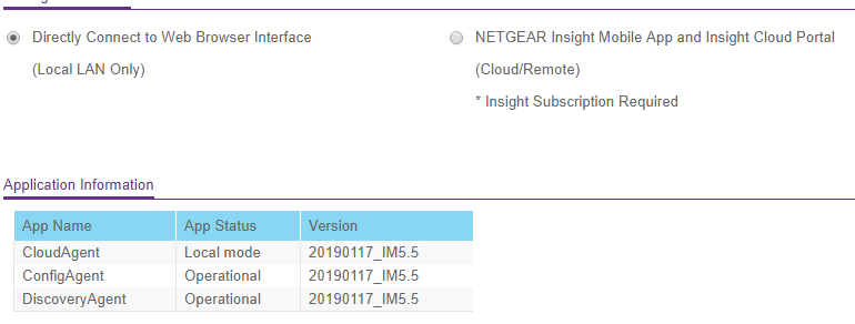

I had to create the account (I created a dummy account) which has registered/linked the device to this dummy user. If I login, it redirects to a internet URL and once i'm in the switch, I see everyting is still set to local:
