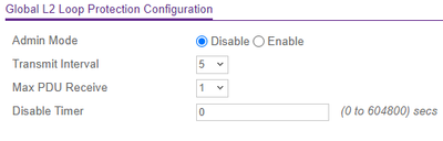

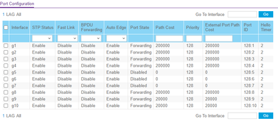

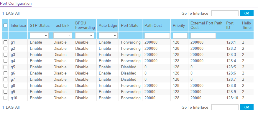

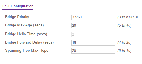

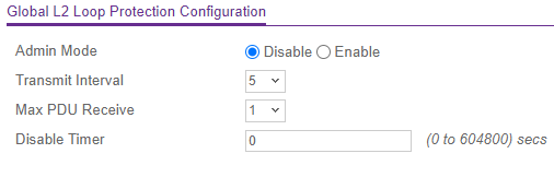

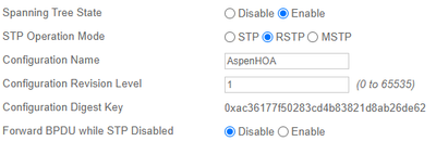

Firmware Version  V7.0.6.3. Having problems with the switch freezing up.
I have a Fibre ring with 11X GS110TP v3,  2X Gs728Tp V2 and 1X Sx3300. All the GS110 tp v3 have had similar problems. I have to manually reboot at least twice a week. I did remove the ring but this did not fix the issue, the fibre with the most traffic keeps on freezing up. i did not have any issues with bigger switches. On the site we have multiple switches linking via Wi-fi and then transfered to these switches.using RSTP configured only on the netgears.
