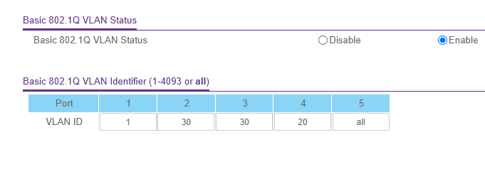

Hi there. I recently purchased a GS308EPP. In basic 802.1Q mode, I temporarily used it to connect: - (V)lan 1 (default Lan): still a few controlling/managing devices; - Vlan 20 : Data; and - Vla...

barreaudb two things I don't understand:
- You talk of a firewall and an AP, but only one port seems to be configured as a correct trunk config - for your use case, I tend to suspect at least two ports with proper trunks.
- What is the idea of overloading the config with more than one VLAN ID as tagged? This is a guarantee for a nightmare. Sure, on a few switch platforms, the so called Asymmetric Switching was sometimes possible (with an additional control, as the switch must support that) - but most decent switches don't support this feature anymore. What does partially work in your case (on both switches when I get you right) is some kind of that.

- barreaudbApr 05, 2025Aspirant

- AP is not at issue here. It's currently powered directly and wired by ethernet to my firewall. It will be powered by the Gs308epp once I have ensured Gs305e to properly work.
- You're right: plan is to have Gs308epp with 3 proper trunks: firewall, AP and wired switchs (perhaps Gs305e's) in 2 other locations. In the future, a camera will be added to Gs308epp.
- Unsure I get the question right on overloading config with more than one Vlan. Do you mean on the switch ? I simply tried to duplicate something that has been working on the Gs308epp as I find Gs305e manual a bit less clear that the latter one
- Just to try to move on, am I correct in understanding yello strips in picture mean that setting has to be duplicated ?
Thanks again schumaku 🙌
to add: I just tried using Basic 802.1Q based mode, as this is the mode used successfully with the other switch.
And I have just noticed that Gs305e doesn't keep in memory the ports set-up when power's unplugged. So at first I had IP attributed wrongly amongst wired devices.
After setting up again and rebooting connected devices:
- IPs are correctly attributed as per lan DHCP server. So I have 1 IP in default lan (switch), 2 IP in IoT vlan (30) and 1 IP in Data vlan (20).
- Lan (wifi and ethernet) access Data.
- IoT access internet.
- IoT has no access to Data despite the firewall rule (that works with the other switch).
