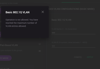

There is a bug on this switch GUI, you cannot create more than 5 VLANs, if you do create a 6th:
Operation is not allowed. You have reached the maximum number of VLAN entries allowed
I have activated:
Basic 802.1Q VLAN
Configure VLAN with Access / Trunk Mode

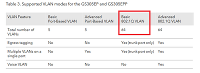

This should support upto 64 VLANs, the manual clearly states it

    The Netgear product engineer is already aware of this bug.
    You could try the Advanced 802.1q VLAN mode instead (I have no such model in use).
