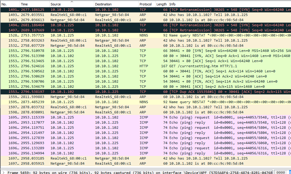

    Some ad-hoc capturing traffic - filtering just the GS308E MAC - does not show any oddities here. ARP are promptly replied, pings start immediately including the replies form the switch.
    GS308E 10.10.1.102 NTGR-98-5d-84

      Thanks for the reply, schumaku. The network is expansive. There are VLAN's to other vendor networks, a few wireless bridges (but they all got knocked out by a hurricane), probably a few loose wiring endpoints, roughly 60 switches, but it's only these four Netgear GS305EP exhibiting this behavior. It's like the management interface is repetitively rebooting. The downstream devices never loose connectivity even though the management interface IP does, so it appears that the switch is not rebooting, just the management interface. It lacks any sort of a log file that I can find. Heck, I can't even get an ARP table off of these. I would like to get some packet captures for functioning and failed ping requests to see what's going on at the ARP level. What app did you use to get the packet capture in the graphic?
        Standard Wireshark (Version 4.0.10 as of writing) on my all-day work horse notebook, connected with a 2.5G link to a Netgear MultiGig capable switch, operated on a 10G/40G backhaul. Good thing is ARP does go everywhere on the VLAN, this is why it's easy to capture in general.
