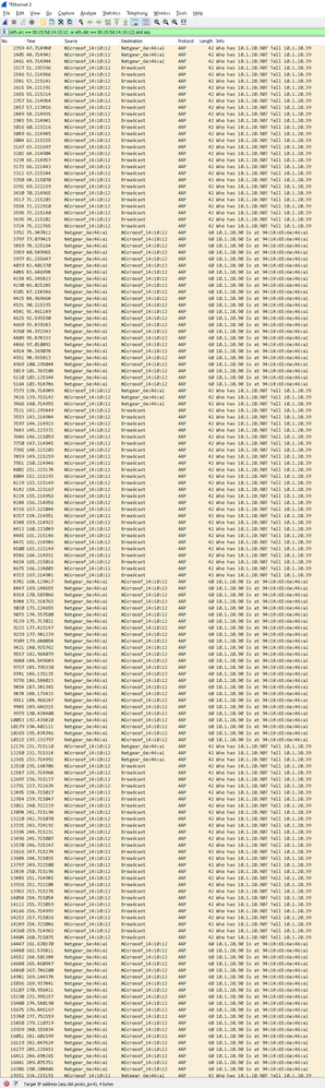

Some ad-hoc capturing traffic - filtering just the GS308E MAC - does not show any oddities here. ARP are promptly replied, pings start immediately including the replies form the switch.
GS308E 10.10.1.102 NTGR-98-5d-84

Thanks for the reply, schumaku. The network is expansive. There are VLAN's to other vendor networks, a few wireless bridges (but they all got knocked out by a hurricane), probably a few loose wiring endpoints, roughly 60 switches, but it's only these four Netgear GS305EP exhibiting this behavior. It's like the management interface is repetitively rebooting. The downstream devices never loose connectivity even though the management interface IP does, so it appears that the switch is not rebooting, just the management interface. It lacks any sort of a log file that I can find. Heck, I can't even get an ARP table off of these. I would like to get some packet captures for functioning and failed ping requests to see what's going on at the ARP level. What app did you use to get the packet capture in the graphic?

Standard Wireshark (Version 4.0.10 as of writing) on my all-day work horse notebook, connected with a 2.5G link to a Netgear MultiGig capable switch, operated on a 10G/40G backhaul. Good thing is ARP does go everywhere on the VLAN, this is why it's easy to capture in general.

Thank you for the information, schumaku. I performed the Wireshark traces which confirmed the ARP behavior. I'm beginning to think it is simply a resource issue on the GS305EP switch. Of the 30 or so ARP requests that go unanswered by the switch's management IP address, I get about 20 consecutive replies back 30 seconds after the initial ARP request so the switch is queueing\caching the ARP requests. My band-aid for now is to simply to add static ARP entries in the management workstation's ARP table. Now there's no dropped ICMP packets to the management interface IP of the GS305EP switches. You get what you paid for, I guess.
