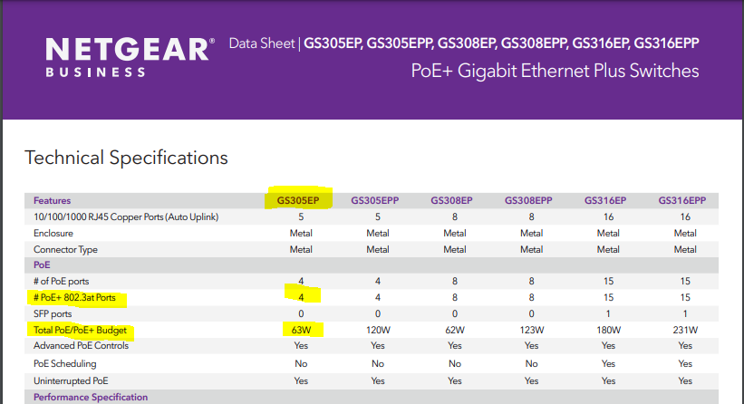

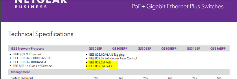

This switch (GS305EP) - i have read a lot of the technical documents, but wanted to be absolutely sure before i bought it...
If I am understanding everthing properly - it's POE+, so 802.3at, hence it's going to be able to supply 13w per port (up to the device limit) and also 44v per port ?

  • Best information source is always the data sheet - Data Sheet | GS305EP, GS305EPP, GS308EP, GS308EPP, GS316EP, GS316EPP

      many thanks for your prompt and thorough reply; i do appreciate it.
      i had read the data sheet before i posted, but felt it was worth double-double-checking before i spent any money 🙂
