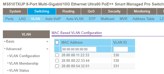

In my reading, the VLAN is created along when adding a MAC Address and a VLAN ID in an authenticated admin session - anything else would bring a massive security issue in absence of GVRP and GARP:
No idea if this UI would allow to define multiple MAC based VLANs for the same VLAN ID.
Well, I'm just yet another user here, and can be wrong. Yes, we have some deployed switches from a big competitor in the field, supporting GVRP and/or GARP. 8-)

Torch24 wrote:
... I don't think the switch allows multiple MAC-based VLANs.
Strongly doubt. Not a GS308T, but another Broadcom based MS510TXUP for example:

I now understand more about the various VLANs.
MAC-based VLANs allow a device (MacBookAir in my case) to connect from anywhere on the network that is connected to a port on the switch and be assigned a VLAN dynamically. Because MAC-based VLAN assignment is a) across all ports and b) assigned before any protocol- or port-based VLAN, the packet gets a VLAN tag and is then processed in the switch bypassing any protocol- or port-based VLAN assignment.
