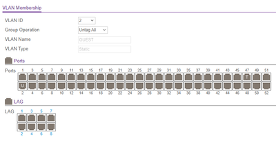

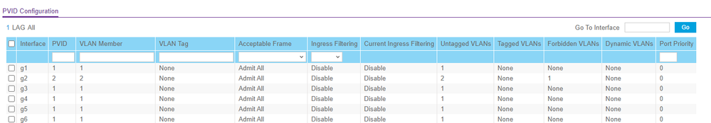

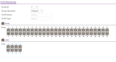

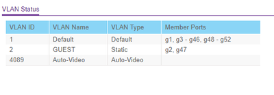

I've just bought a GS348T switch and after some test for VLAN implementation, I've found a weird behaviour of the switch.
The VLAN setup is very simple, port g2 and g47 are in the VLAN 2. All other ports are in VLAN 1 as untagged ports.
For VLAN 2, the port g2 is Untagged and g47 is Tagged (cause other switch send this VLAN tagged too).
The problem comes when connect the cable from the other switch to the g47 port.  I've checked that both VLANs are working correctly and has communication with other devices in their respective networks. But the switch cut any communication in his management IP and even ping doesn't respond.
As soon as I've disconnect the cable on port g47, ping respond and the web management interface come back.
I've attached some screenshoots with the config...
