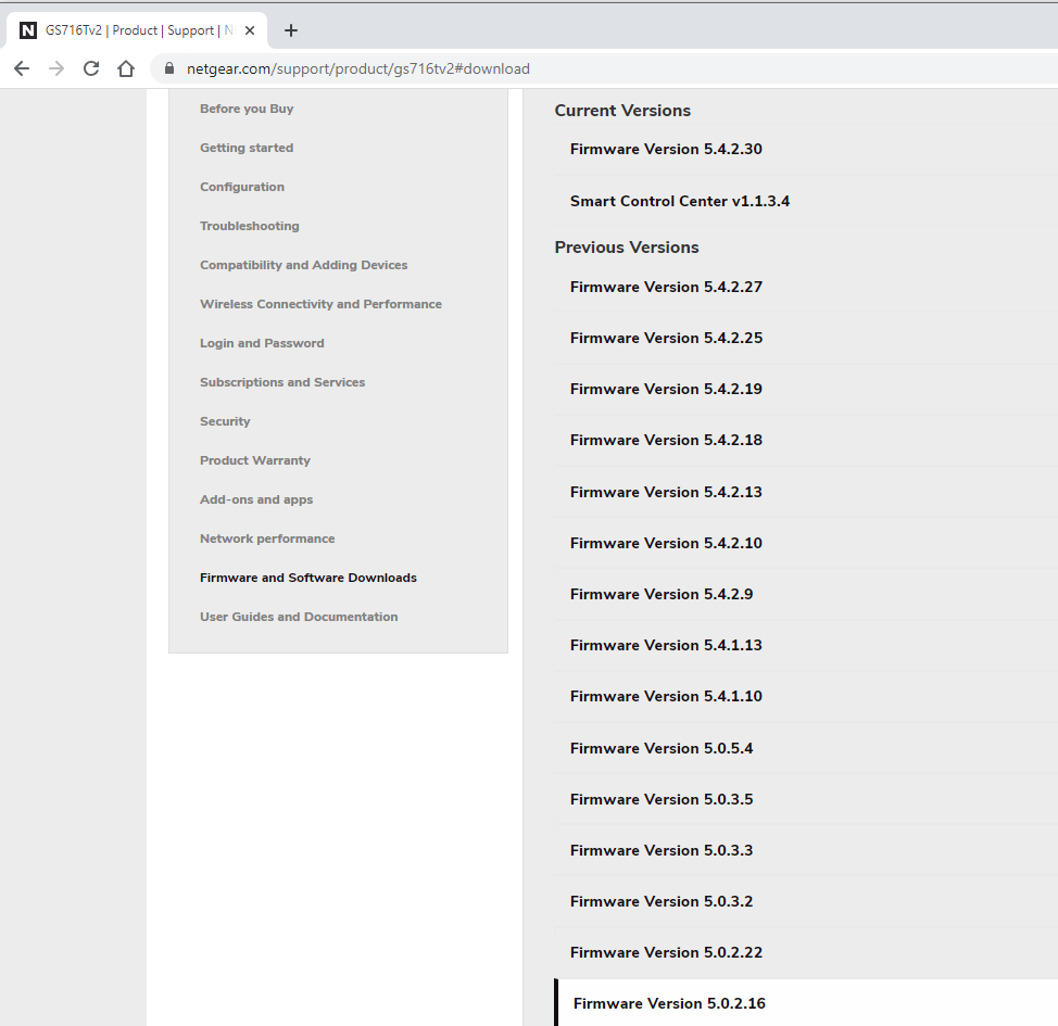

  • Looking up via https://www.netgear.com/support/product/gs716tv2#download -> View Previous Versions, the GS716T operating on Firmware version 5.0.2.16 this is apparently a v2 hardware version ... and it certainly requires a firmware update for a longer time. 8-)
    Please carefully browse over the releases shown for any potentially required special update handling.
