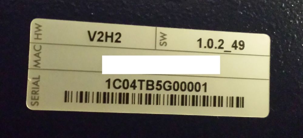

GS724T model version for firmware upgrade
Please help id the correct model (photo attached) of this Netgear GS724T for firmware upgrade.
Thanks
  • Hi snowdn,
    Welcome to the community! :)
    I checked the serial number and the switch model you have is GS724Tv2.  The latest firmware version that was last released for the GS724Tv2 is v1.0.3_35.
    Since you wanted to update the firmware to the latest version, I advised you to do it in a ladderized manner.  For example, update the firmware from v1.0.2 to v1.0.3_30.  Then, from v1.0.3_30 to v1.0.3_33 and so on until you reach to the latest firmware v1.0.3_35.  Be sure to perform a factory reset on the GS724Tv2 switch after upgrading the firmware to the latest version then reconfigure the settings from scratch in order to start clean using the latest firmware version.
