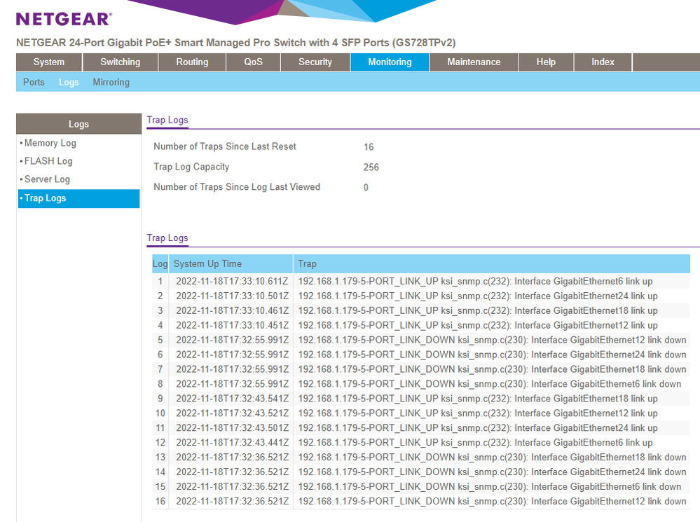

I logged into the switch and saw this on the trap log

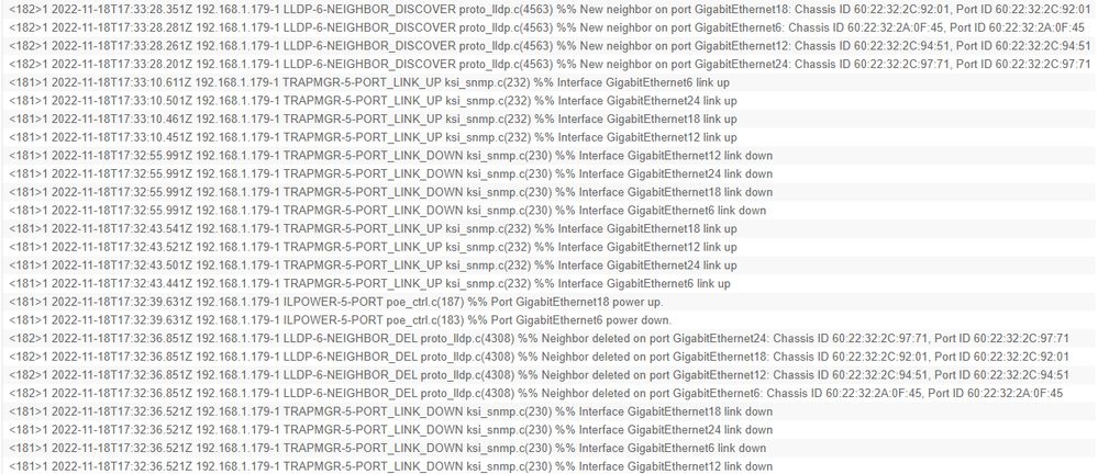

and this was the memory log
if it was one or two aps going down then i would think cable issue, but it looks like all 4 went down at the same time. Can anyone give me any pointers what to look at/check please?
