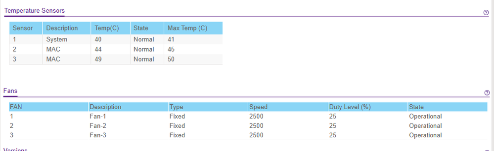

    Not sure, there are no Temperature and Fan indications on the System Information page? In the earlier years, Netgear had implemented private MIBs NETGEAR-BOXSERVICES-PRIVATE-MIB like https://www.circitor.fr/Mibs/Html/F/FASTPATH-BOXSERVICES-PRIVATE-MIB.php where Fans and Sensors tables are typically accessible.
    This is an example taken from a recent MS510TXUP:
