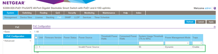

GS752TXP PoE stops working
I have a total of 4 GS752TXP switches, but one of them, the PoE works for sometimes if I reboot the switch, but eventually the PoE devices (cameras) connected to the switch turns off. I have the sam...

tantony wrote:
When I go to the PoE section of the affected switch, it says Invalid Power Source. What does this mean? Because I tried different power strip outlet port, and a different power cord, but its the same issue.
These switch platforms have the internal ability to be run from multiple power sources, even if not enabled physically on these models - there is no backup power connector available.
Request a hardare replace via https://my.netgear.com - select the device in the list of registered units, and follow the [Request a hardware replacement] process.
