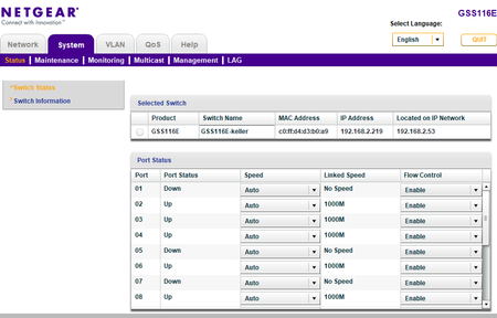

GSS116E unable to upgrade firmware from 1.0.0 to any available firmware
Hello,
I was trying to update my Netgear GSS116E switch from firmware version V1.0.0.0 to the current version (as of this time, this seems to be V1.6.0.5).
Since the support pages already stated ...
