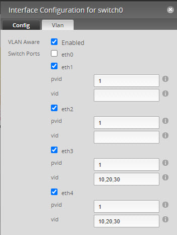

How do I configure VLAN with Netgear GS308E and Edge RouterX
Hello, I am trying to figure out how to configure VLANs on Netgear GS308E to work with Ubiquity Edge Router X. My current setup (as in the diagram) has two access points. AP1 is connected directl...

For complex 802.1q VLANs configs use VLAN -> 802.1Q -> Advanced only.
Add VLAN 10, 20, and 30 to the VLAN config.
For the uplink port and the AP port, add VLAN 10, 20, and 30 as [T]agged.

- schumakuJul 22, 2020Guru - Experienced User

Thank you schumaku . Do I need to configure anything in the "Port PVID" section?
