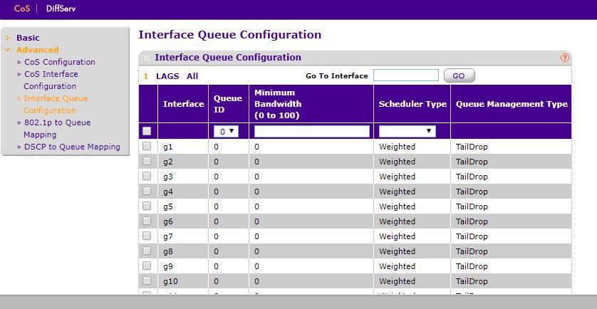

In the GS748T I can see the following:

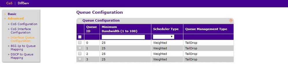

Unfortunatelly, I can't get to see the ports/interfaces in the GS728TP:

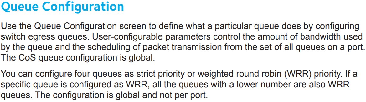

    As per checking, these switches has different firmware and hardware models. I double checked the manual and it seems that the GS728TP only supports global configuration and not per port unlike the GS748TP as each port has its own CoS queue-related configuration.
    GS728TP:
    GS748T:
    GS728TP:
    GS748T:
