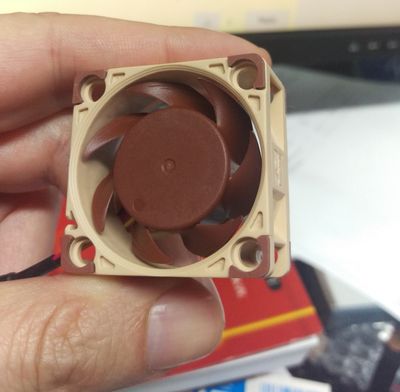

How to raise fan speed on XS708T
Is it possible to raise the fan speed at say 100% ? Currently is 21% giving MAC t=42° and PHY t=51°. Thanks to all replies.
- Nov 22, 2017
UPDATE: The Noctua NF-A4x20 PWM is an absolutely perfect fit for this, comes with all you need, and makes this switch 100% silent while keeping temperatures in check. Excellent recommendation, thank you.

First try:
Noctua NF-A4x20 PWM http://noctua.at/en/products/fan/nf-a4x20-pwm replacing the stock fan.
Good (low pitch noise) but sadly unhappy positioning of the air outlet (directly on my concrete wall).
I suggest to test this combo, seems very promising: small price and 2 minute screwdriver work.

fcorbelli wrote:First try:
Thank you very much for this recommendation!
- SquuiidNov 22, 2017Luminary
