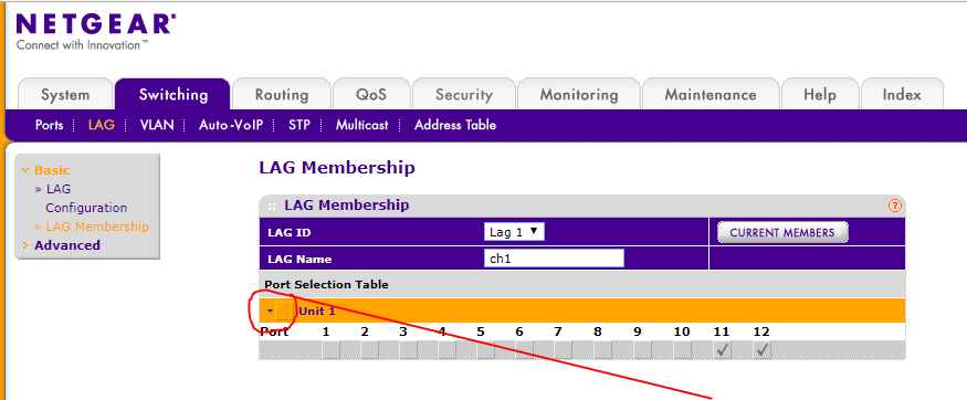

I have a GS752TS and a GS748TP Switches that I want to create a lag between.
I inherited this network and I want to create a lag between my GS752TS and GS748TP switches. The problem is when I web access to the switches and start to create the lag, I can't add any ports to the lag. It seems this area does not show up. What am I doing wrong! Any information would be very helpful.
I added the I.P. to the browser compatability list and now all the menus show up.

The only problem is where your red line to add the ports to the lag is, mine does not show up so I can add the ports. Does the switch need to have the firmware upgrade? Or use a different browser?
- schumakuGuru - Experienced UserIt should be possible to select the (one and only) unit there where the red circle is, so the line with the ports does show up.
This old UI design should (and does for me) work e.g. in Chrome, IE11. For Firefox or Edge I would have to check again.
