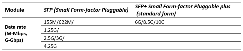

    While in the first view, a "passive cable" sounds like a possible approach, the cable respectively the two connector modules at the two ends, does indicate much higher data rates (only!) than the GbE (technically operating at maximum of 1.25 Gb/s on the SFP port) does handle.
    SFP and SFP+ transceivers are virtually identical in size and appearance. The primary difference is that SFP+ is an updated version that supports higher speeds up to 10G/s. The difference in data rate also accounts for a difference in transmission distance - SFP based on SFF INF-8074i typically has a longer transmission distance. SFP+ specifications are based on SFF-8431. In terms of SFP vs SFP+ compatibility, SFP+ ports often accept SFP optics but at a reduced speed of 1 Gb/s (exact PHY rate 1.25 Gb/s).
    Be aware, however, that you cannot plug an SFP+ transceiver into an SFP port because SFP+ does not support speeds less than 6 Gb/s.
    Sometimes, even a successful established link is indicated to the switch and the link and the switch does turn the LEDs on, while it's establising a much faster link than the switch - but no data does and can flow.
