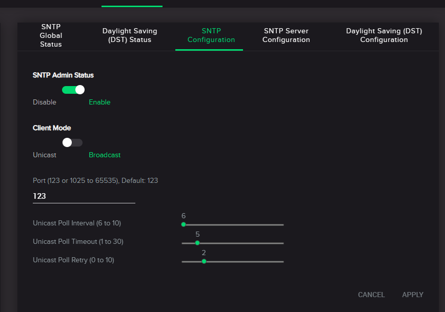

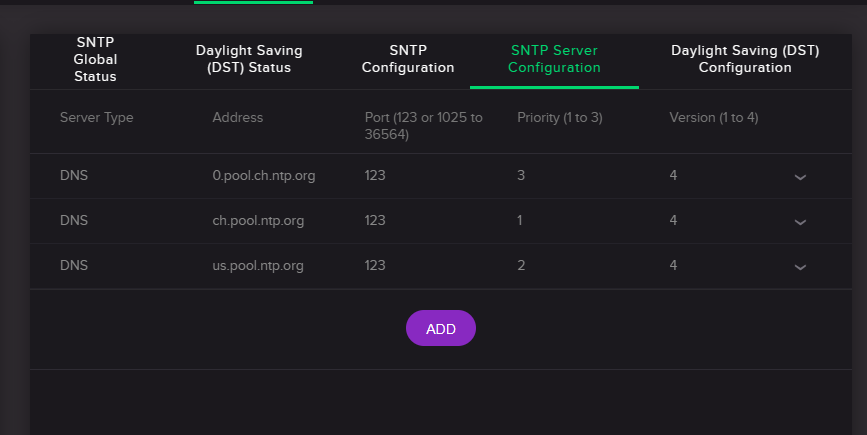

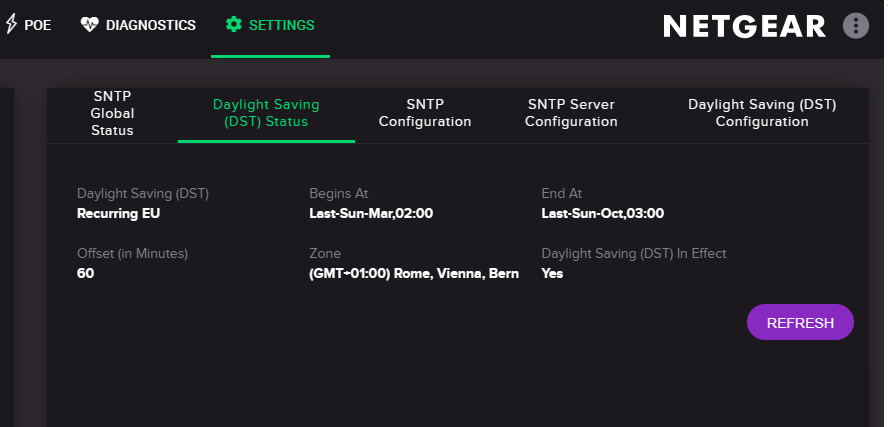

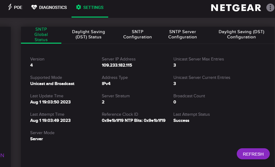

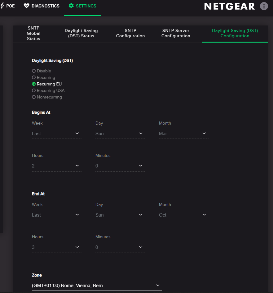

- Some images of the SNTP and DST configurations - hope this does help. Have only a similar switch at hand, slightly different UI however. Key is to configure unicast servers (not broadcast). - Sorry for replying in English. Fluent on reading however, old Swiss here, but not so easy to write 8-)
