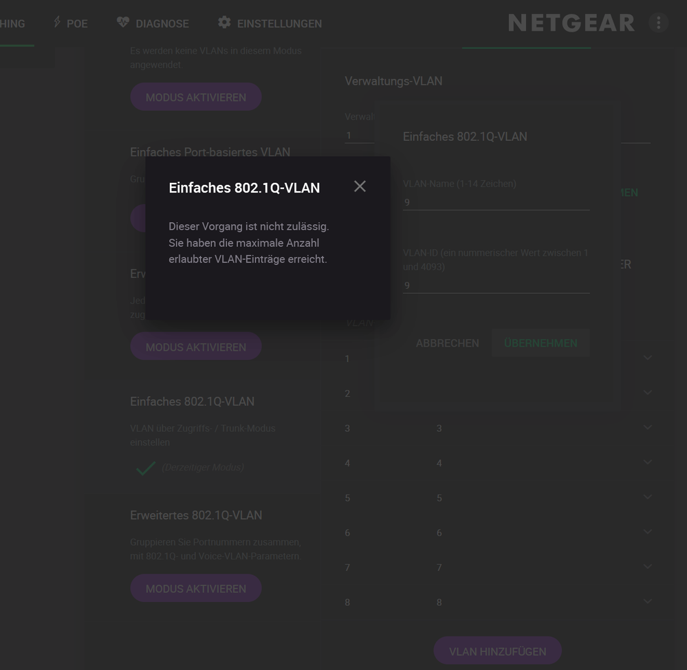

I would prefer the GS308EP to handle 64VLAN even in Basic 802.1Q VLAN mode instead of 8VLAN
I mean I would prefer the GS308EP to handle 64VLAN even in Basic 802.1Q VLAN mode instead of 8VLAN...
schumaku
Aug 31, 2026Guru - Experienced User
A moderator has split the partially off-topic discussion - thank you! (was: Off-topic here)
The number of supported VLANs in the Basic 802.1Q VLAN mode is limited to each switch model number of ports, like 5, 8, and 16. This is a basic design decision, keeping the simple Web UI, and avoid "impossible" configs.
For users requiring larger and more complex VLAN designs, the Advanced 802.1Q VLAN mode is always available - so up to the max of 64 VLAN, a management VLAN, and much more.

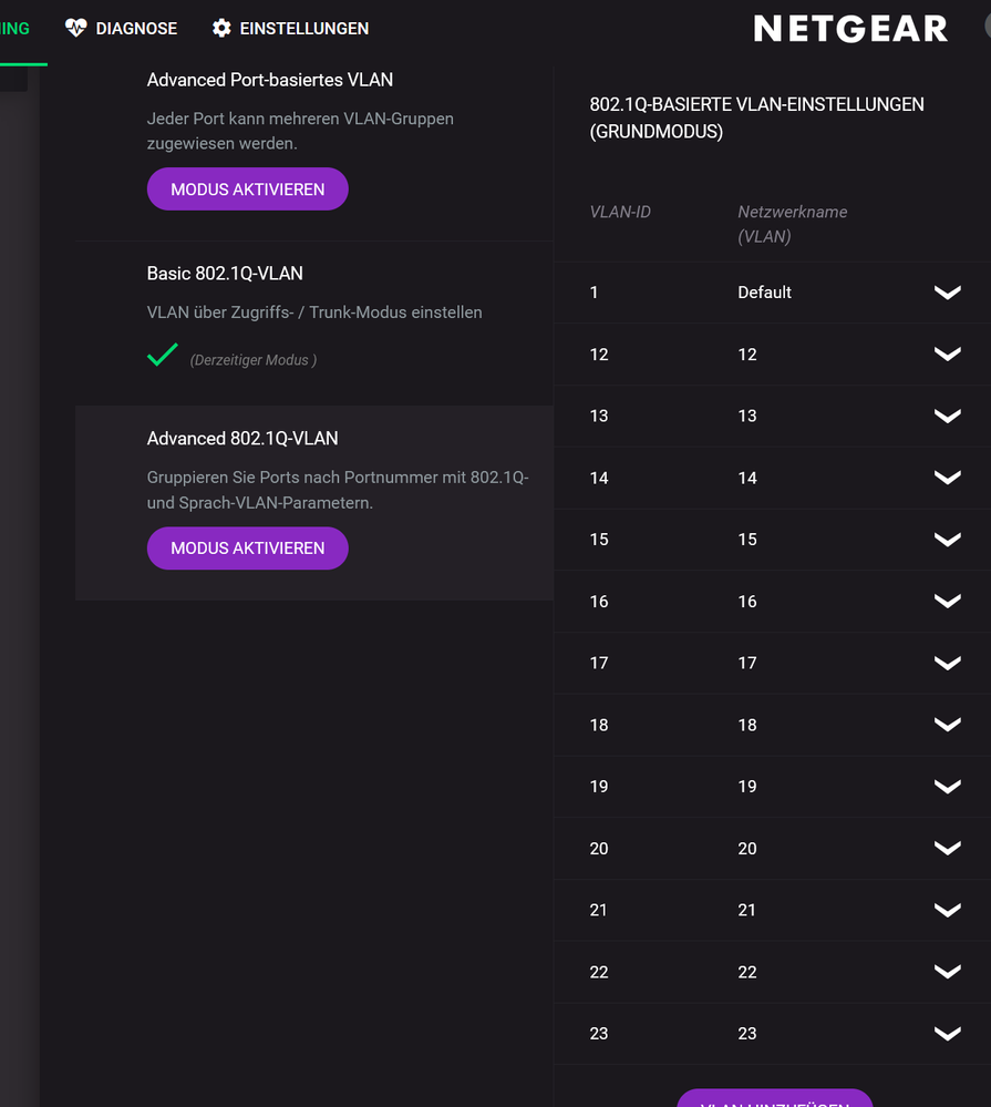

*On the VLANs limitations :
I understand your point, but this really is limiting these little switches to the far end of the edge, or almost so.
But even then, the consistency of detailled features accross the little Netgear manageable switch range is not very good.
Hopefully the VLAN advanced mode is here, you're right, but VLAN basic mode is what most expect, and the artificial limit, arbitrarily set as the number of port, is very restrictive when you need a basic trunk port.
Please keep in mind a port configured as a trunk need VLANs to be declared in the GS308EP/EPP to pass-through this trunk... To me, an 8 port manageable switch, made by Netgear should be capable to handle that 64VLANs in Basic Mode also.
Users with more advanced VLAN needs, will look for many other features anyway. In other words, setting a higher limit will not cannibalize pro gear, but this is an open discussion.

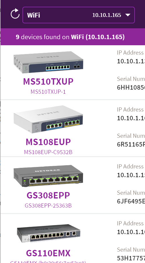

Indeed, on the contrary to the more modern MS308E I use for reference, the GS308EPP does not implement the NSDP (Netgear Switch Discovery Protocol), nor the mDNS Discovery.
- All the GS108EP/GS108EPP/GS308EP/GS308EPP are - on the configured Management VLAN with the v2.0.0.x firmware - perfectly supporting mDNS Discovery, becoming visible on Windows 11 Network computers (on the appropriate VLAN or wireless SSID).
NSDP (Netgear Switch Discovery Protocol) is obsolete [as known insecure for configurations, and spanning the complete L2 networks]. As such, it was removed from products not depending on the NSDP discovery - where mDNS/SSDP became available.

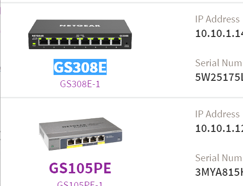

Older models like the MS305E, MS308E, GS308E, GS105PE, or the GS108E model versions 3, and 4 (earlier models did not had a Web UI), continue to be discoverable by the NETGEAR Discovery Tool - using NSDP.

But (sorry I'm complicated), then, the GS308EPP switches are not discoverable by the Netgear discovery tool anymore.
mDNS/SSDP is the only discovery protocol remaining supported:
The legacy NSDP had to be removed to free-up Flash and Memory on these really tiny and minimal resource switches along with the introduction of the now also obsolete GS308EP Firmware Version 1.0.1.4Keep in mind mDNS/SSDP as implemented on the IP stack, which is limited to the Management VLAN configured, will only appear that VLAN.
While NSDP can be discovered anywhere on the L2 network, regardless of the VLAN config - even in the absence of mDNS/SSDP, these are perfectly visible in the NETGEAR Discovery Tool:

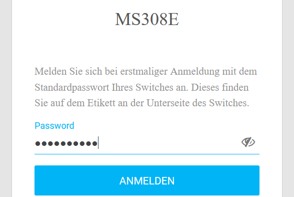

Have received, unpacked, updated to 1.0.0.9, and started to poke around on the MS308E.
First impression?
- The boot-time of the MS308E is factors (yes, feels almost like one minute here) longer than from the smaller GSnnnE(xx) models (smaller or no self-test, no managed core boot, no plain text CLI config interpretation, ...
- The Login-page does not have a correc/complete style sheet - this becomes obvious when looking at the default fonts in place, well visible on Firefox. This was (kind-of) addressed on the GS108E models with the new Web UI a long time ago. NTGR should review the changes there please.
- The Login page of all these small Easy Smart Essentials PoE (born as as Plus) Switches looks like a relict of the past - what it really is, it a remaining part of the old UI design in fact.
- Lets leave the incomplete translation away for the moment, since Password on German is Passwort 8-/
Yes, the MS308E does easily take more than the artificilally set limitation to the number of ports we see on the GS3nnExxx models:
Considering even the very "small" GSnnnE variants can take up to 64 VLANs, and deal with much more complex configs than just a generic (universal) [T]agging and trunk config plus an Access port config set on some of the available ports, I can't think this restriction of VLANs to the number of ports does (different from the simple Basic and Advanced Port Based VLAN options) make any sense.
Yes, I do agree with lightblue - this limitation can easily be removed, without any negative effects.

- the borked login form, lacking of correct, CSS based, design - believing the browsers default font will somehow match
to the product management and QA please. Thank you in advance!
