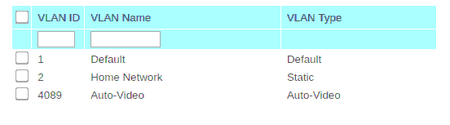

Hello, I've some vlans configured. I'd like to monitor VLAN statistics using ifTable MIB table. But when I test using snmpwalk, I only see entries for the physical ports...
