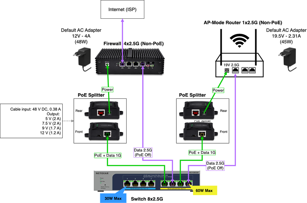

      Sounds almost too good to be true. But if it is as you say, if I have 3 possible PoE splitters to choose from, rated the following:
      • 30W, 12V 2.5A
      • 60W, 12V 5A
      • 90W, 12V 7.5A
      Then what you mean is that it doesn't matter which one above I choose from despite the ratings for i.e., the firewall router if I want the MS108EUP to power it using PoE?
      I noticed that the PoE-splitters out there are limited to 1GbE, which is why I was planning to run PoE and Data on seperate Ethernet cables so i can still utilize 2.5G. I noticed most of the splitters are compliant with 802.3af and 802.3at.
      I made this diagram to illustrate how I was thinking. The red X on the splitters are replaced with the purple arrows which transmits the 2.5G data, and the PoE on those two ports will not be utilized . Willl the switch be able to power both firewall and AP-mode router properly?
      Note: The diagram shows a different splitter. I think that the firewall would be fine, but I am not sure about the AP-router since the voltage of the splitter isn't high enough.

        The 30W, 12V 2.5A is is to small, so this is out.
        For a proof of concept, test the config with whatever the firewall requires on the power side. Note: You might have to power it from a 60 W port - as there is not 90 W port on the GS108EUP available, so the 90W, 12V 7.5A is out.
        Have some manufacturer or vendor URL of these devices at hand? Could be interesting for the community members.
        This was meant in relation to the two options we talked about before. Looks like the vendor (or the industry) is not ready for a powerful PoE++ like this simple MS108EUP.
        geee, this would make it a show stopper. These injector obviously leave industry standards out of mind, completely mis-balanced products. If they talk about 30W and 60W injectors, I would expect full bandwidth support, not cheap 802.3af and 802.3at.
        More of these models for the scratch list. Not ready for a 2023 PoE++ project in my opinion. Sorry for destroying the illusion. .
        If these power injectors can't offer the required nominal voltage, this is a no-go.
        For the firewall, if powering over a network cable is an absolute must OK.
        Considering there are great powerful WiFi 6 dual-band and Wifi 6E tri-band PoE++ AP readily available in the market, it's definitively to build such a resource wasting design (dual network cabling through the house, two expensive PoE++ 2.5 GbE port is a more than just a little bit shocking to me. Unless you are a system or hardware vendor and want to show off some proof of concept, oh well....
