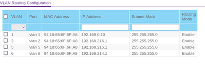

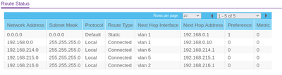

MS510TXM need some general assistance with Routing config
Hello everyone! I'm running a MS510TXM with fw 1.0.5.10. I'm trying to get VLAN routing working and I'm having trouble. From all subnets/VLANS (tagged & untagged) I can see the gateway addre...

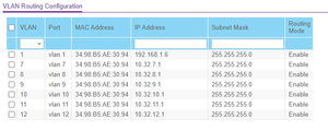

HI,
Iḿ in the same situation, it looks like this product is not capable of routing packets between two VLANS!!! No matter what yo set in the configuration. I have 2 vlans assigned to 2 ports in native(untaged) mode and the .1 in each subnet assigned to the switch. Setting one PC on each port and VLAN and trying to ping from one to the other(no windoze firewall enabled) fails.
I have set a static route to my internet router that is connected to another port an VLAN and not even that is working if I set another PC in the same VLAN and point to the switch address as default gateway. This is a complete disaster and this switch is a joke as a L3 lite router.
