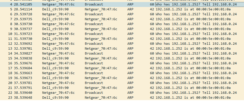

Hi,
I have noticed that the switch cannot communicate with any VRRP router.
I mean any device with a MAC address of 00-00-5E-00-01-XX.
The switch simply sends ARP packets over and over, but does not accept a response with that MAC address.
No network packet for the destination IP address ever leaves the switch and it claims that a connection timeout has occurred.
There is no problem communicating with the same target host and its physical interface.
I have other Netgear devices, such as the GS752TPP, connected on this network and they work as intended.
Any possible solution to this problem, perhaps a software update?

Undoubted, a valid Virtual Router MAC address https://datatracker.ietf.org/doc/html/rfc3768#section-7.3 ... work for Netgear Switch engineering. BretD please handle it accordingly, thank you!
