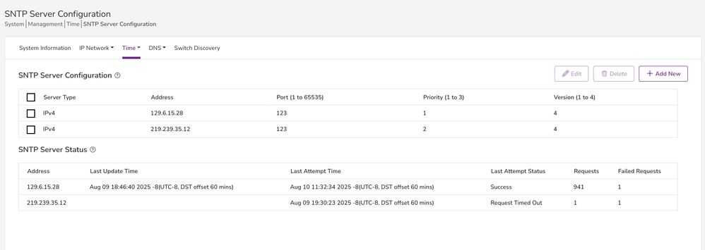

  • Here are my screenshots from before and after:

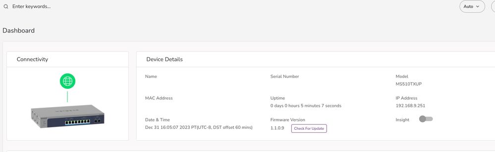

    1.1.0.9. works with SNTP settings:

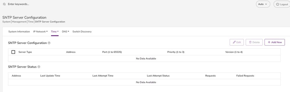

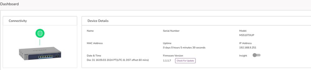

    then upgrading to 1.1.1.7:
    As you can see SNTP entries are empty and gone.

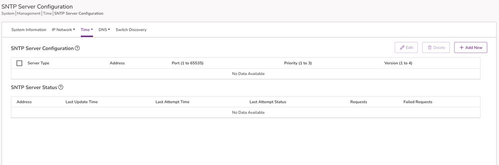

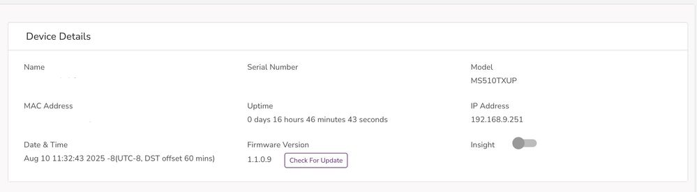

    Switching back to 1.1.0.9
    SNTP entries are still gone and have to be reset.
