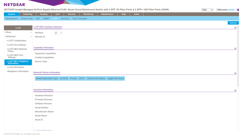

How can I see the IP and MAC of the devices connected to my port? Neighbor Info are not available

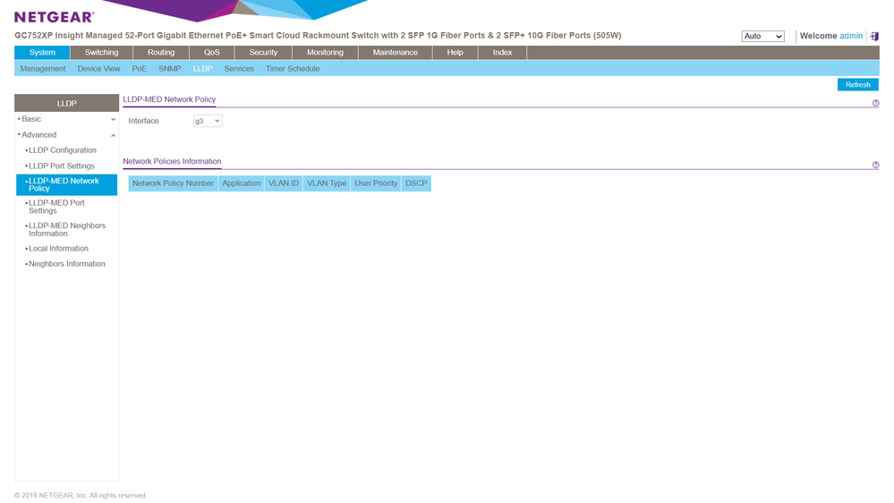

In the LLDP configuration I also cannot see the IP and Mac of the device that is connected to my port.
schumaku
Dec 09, 2020Guru - Experienced User
ivanmorato wrote:In the LLDP configuration I also cannot see the IP and Mac of the device that is connected to my port.
Probably I was not clear. LLDP-MED (so an LLDP agent) must run on the other side, e.g. a Linux or Windows system, or on a switch, and the port must be enabled for LLDP-MED. And finally, the information returned can be limited or vary.
Beyond it's a little bit difficult because as in-line images require moderation before these are becoming visible.

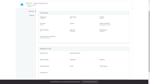

Edit: Just see the first post images ae visible now. You are talking of Insight. Anything under "Neighbor Information" is LLDP-MED sourced. No MAC or ARP table information.
What is connected to Port 3, 9, 17, and 21?

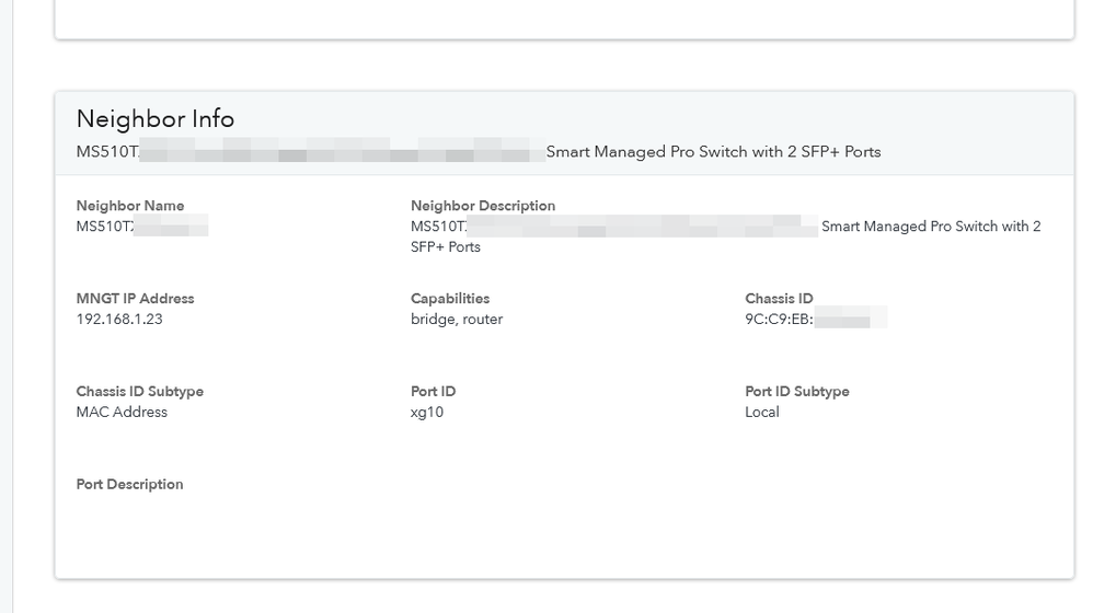

Here is the Neighbor Infro form a per supporting LLDP-MED:

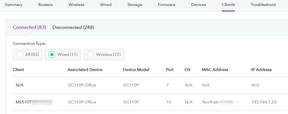

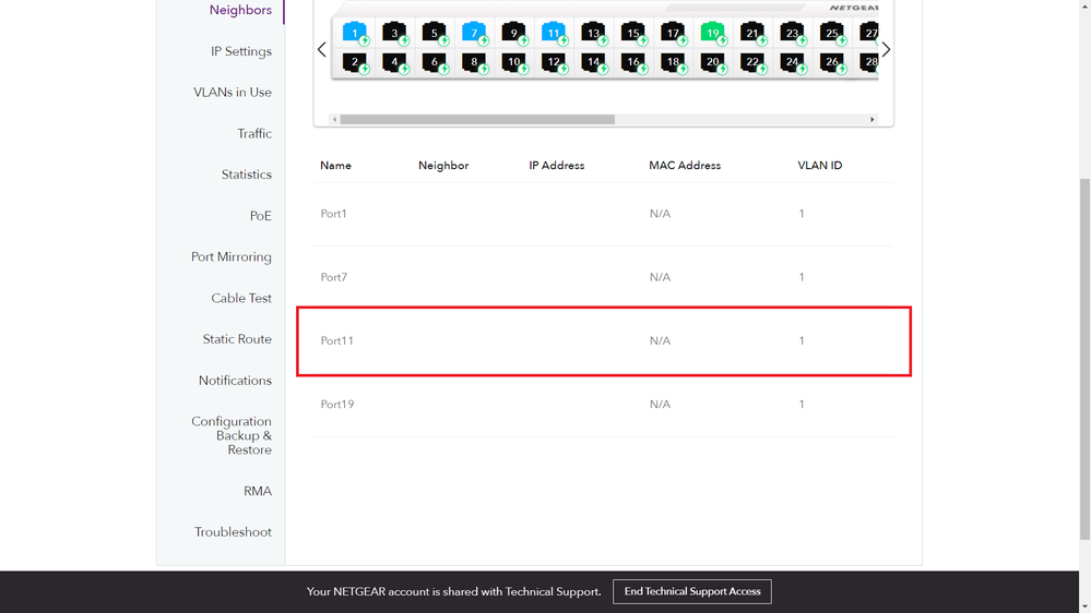

Non-LLDP-MED deivces show N/A for the wired conncted devices:
This is an inconsitency - nothing we can do to see the non-LLDP-MED devices MAC and IP for now.

Is there any way for me to have the IP and MAC information on the Insight Cloud?Port 3 - LTE Modem - NetGear LB1120-100NAS
Port 9 -WiFi Router - TPLINK TL-WA801ND
Port 17 - Notebook - Dell inspiron 15 Notebook (Windows 10)
Port 21 - RFID Sensor

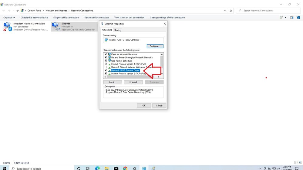

Windows 10 - ivanmoratoDec 11, 2020Aspirant
My windows 10 has the LLDP protocol enabled, on port 11. Netgear still doesn't show the information
- schumakuDec 29, 2020Guru - Experienced User
The driver alone isn't sufficient - DCB installtaion is required, then you can enable the NetLdpAgent wIth the cmdlets in PS.
