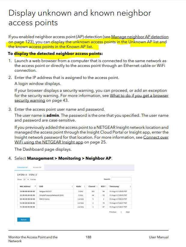

    ugonzalezh31 wrote:
    What is it for??
    Suggest to read the chapter "Display unknown and known neighbor access points" again.
    Something like a Scanner Radio 8-)

      • schumaku's avatar
        schumaku
        ugonzalezh31 wrote:
        My ignorance still does not allow me to see how to get any benefit from the Neightbor AP feature, ...
        This is a monitoring feature. Each AP is re-evaluating it's wireless environment on a regular, kind-of semi-random schedule. It does collect from what the AP does "see" on the air, and list wireless MAC (BSSIDs) and wireless names (SSIDs) in tables sorted to two tables: Some are known to the access point (because there is a logical dependency), others are unknown to the AP (neighbors, rouge APs, other wireless systems, ...)
        Monitoring > Neighbor AP
        Unknown AP List
        This page displays the list of unknown Access Points. The list retains the latest 200 (or less) neighbor access points. Inactive entries are removed from the list after 12 hrs. Use the Refresh button to update the list of access points
        Use the Refresh button to update the list of Access Points.
        Known AP List
        This page displays the list of known Access Points.
