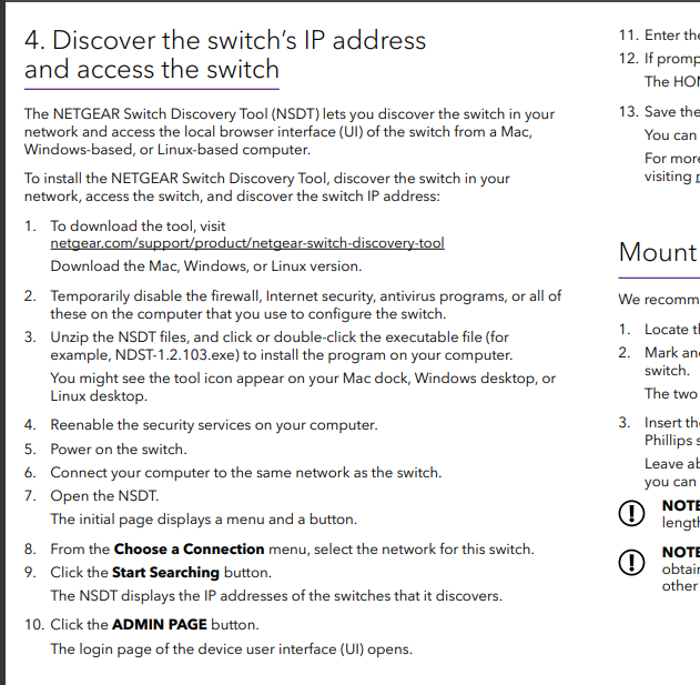

    Not at all an issue with these Switches. Please look again into the fine GS108Ev4 8-Port Gigabit Ethernet Plus Switch documentation . For many reasons, both the Installtion Guide or the User Manual.are referring first to the Netger switch Discovery Tool.
    Like almost any device or applince with a LAN connection, these switches have a DHCP client on board. This will make the device fetching an IP config from your network DHCP server, typically your router.
    Only, and -only- if there is no DCHP server on the network, the DHCP client will fall back to the default 192.168.0.239 IP address.

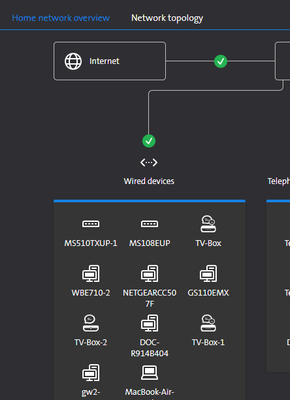

    In case you don't believe into what the NSDT does show, login to your router, to locate the connected devices:
    Convinced somehow selecting the device will show the effectively assigned LAN IP address, it's MAC address as a reference (conveniently ls printed on the product box and the devuce itself.
