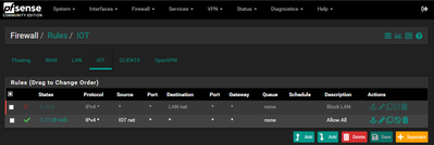

I have the Netgear GS724Tv4 linked to a pfSense 2.6 router on port 24. I have configured a VLAN 50 on pfSense as IOT. The Block LAN rule is temporarily disabled for testing. Thanks in advance.

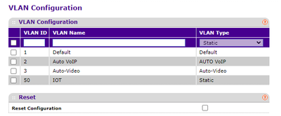

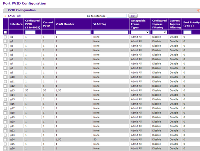

I configured a VLAN 50 on the Netgear Switch

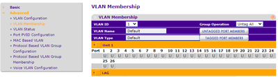

I have configured VLAN 1 on Port 13 as Untagged and as Blank with the same result.

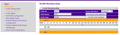

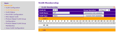

VLAN 50 Membership I have tried to tag and untag the VLAN port with the same result.
In Port PVID Configuration I selected Port 13 and added 50 to Configured PVID (1-4093) The result:

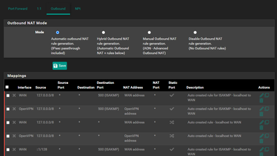

After going over everything for the 100th time I went back to pfSense and although I had disabled the VPN to test this switch I did not move the NAT from Manual to Automatic.
Once I did that it opened up internet access. I will need to explore pfSense NAT outbound rules before enabling the VPN again.

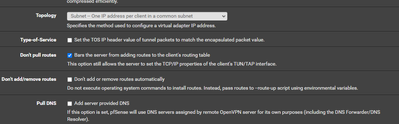

I returned OpenVPN NAT Outbound to Manual - I went back to :
Halfway down I checked Don't pull routes.
This added default rules to my NAT Outbound and allowed the VLANS access to Internet. Just an FYI for anyone else who comes across this problem.
