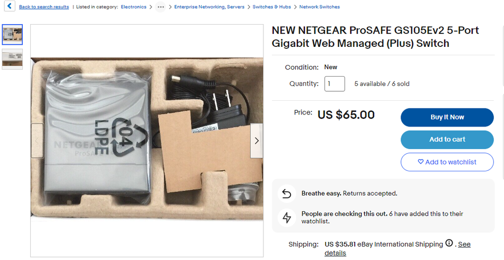

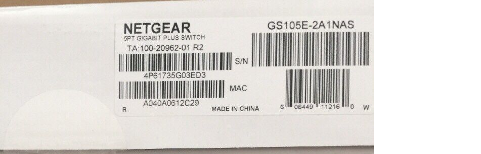

Some smarta** are still offering these OEM as "NEW ProSAFE GS105Ev2 5-Port Gigabit Web Managed (Plus) Switch" e.g. on ebäh for 65 USD - luckily they show the original manufacturing label clearly identifying it as a GS105E-2A1NAS. At least, they accept returns - fair enough.
Reminder: A correct retail GS105Ev2 intended for the North American market would be GS105E-200NAS, -not- a GS105E-2A1NAS ...

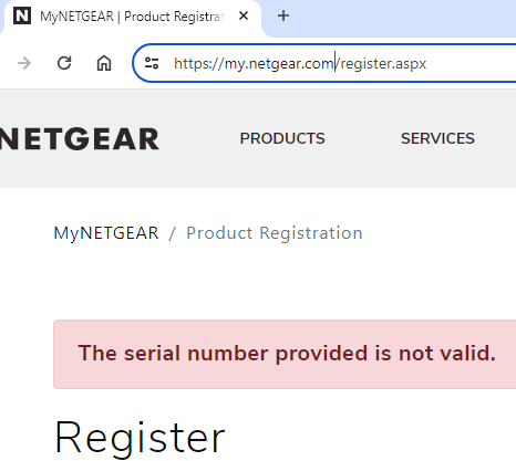

The good thing is that these OEM serial numbers can't be registered with my.netgear.com
