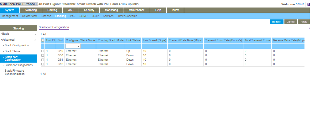

In case it is useful here is a screenshot of my ports and their status. If any other screens are helpful just let me know.
- DaneANETGEAR Employee Retired
Welcome to the community! 🙂
If you are not using the compatible SFP module for the S3300-52X-PoE+, then there is no guarantee that it will work. NETGEAR recommends to use the compatible SFP modules for the S3300-52X-PoE+ as indicted on page 14 of its data sheet here.
