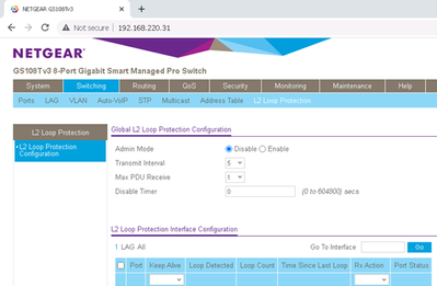

      Has there been a loop in your network that's why the port stopped passing traffic? How often does this happen?
