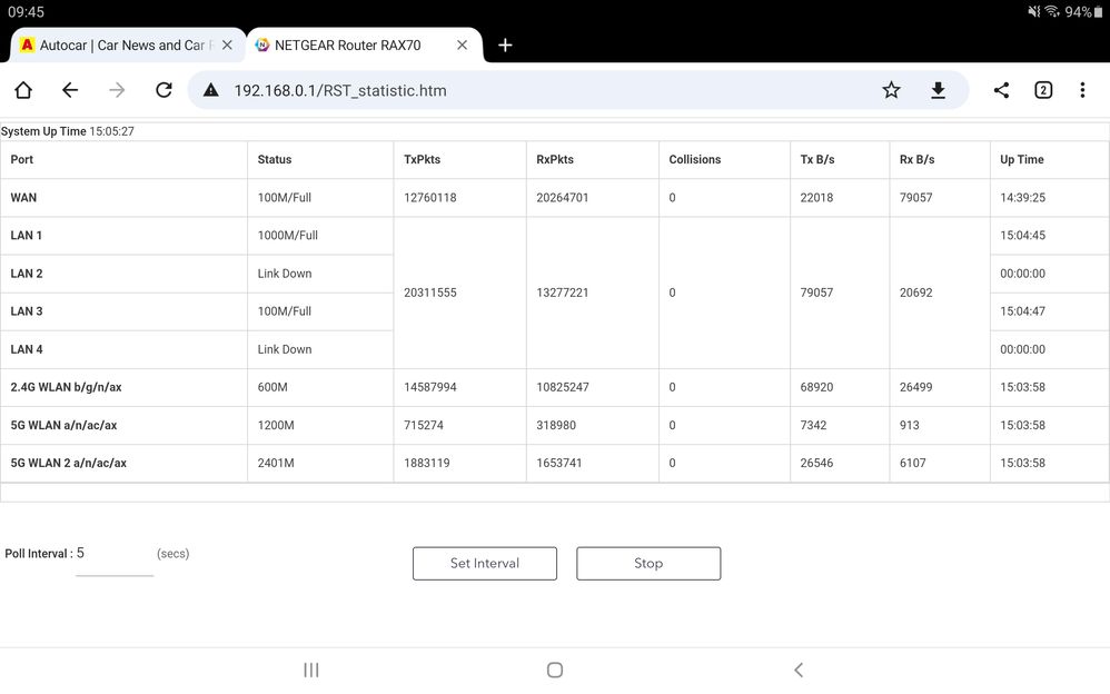

My router is randomly and intermittently turning off it's wired and WiFi connections, which means every device connected loses it's connection.
It occurred several times yesterday and sometimes occurs on a daily basis. It does turn on again after a while, as can be seen by the log attached.
The router still has a hardware warranty and I'd like to swop it out for another, how do I go about this please as technical support has now ended and I can't seem to create a support ticket anymore.

      Thanks, the router has firmware version 1.0.14.134 and it's connected to a modem, however that shows it is still connected to the internet. Not that it matters as clearly it is the RAX70 that's dropping every connection randomly, all at the same time, as in it hasn't occurred today but yesterday every single connected device dropped offline several times to the router. This presents issues in itself as I have a NAS drive and a file server that must be connected at all times.
      • cuke2u's avatar
        cuke2u
        I was able to witness more what is occurring as the network cable disconnected came up on my tv this pm. Looks like the router is rebooting itself as all the lights on the router went off, bar the power one that turned orange, then after a while all came on again and the network cable reconnected message came up on my tv.
