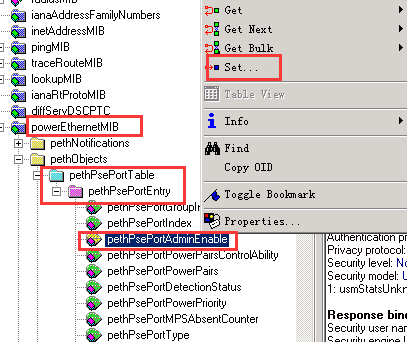

Greetings Community,
i need to enable/disable POE on switchpots adimistratively from remote. I cannot use the buit in feature like scheduling, hence i would like to go ahead with snmpset.
What is the correct OID to touch interface X in that manner and the value for on/off?
Which MIB is relevant for this task?
Thanks a lot and best regards!
  • Hi Tc43,
    Welcome to NETGEAR community!:smileyhappy:
    We can use the public MIB POWER-ETHERNET-MIB to control PoE status through SNMP.
    Please reference following screenshot to deploy.
    May the solution help you.:smileyhappy:
    Thanks,
    Daniel.

  • Hi Tc43,
    Thanks,
    Daniel.

      Hello Daniel,
      thanks a lot! I got it running with your hint!
      Best regards!
