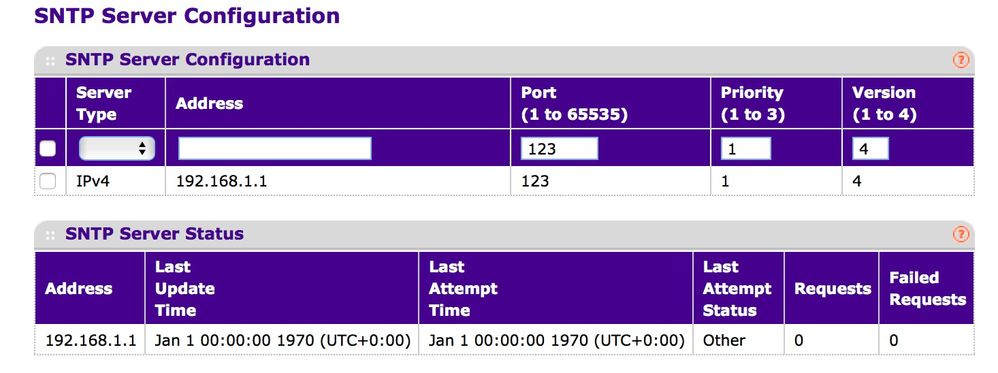

Time Configuration problems on a GS724Tv4
I am having problems getting the SNTP Time Configuration client to work. Its doesnt even look like its trying to get a time from any server I enter. Has anybody got any advice on how to make it work?...

Jul 31, 2017NETGEAR Employee Retired
Thanks for the update. Were you able to try to set the the SNTP Server Configuration as 192.168.1.1 which is the LAN IP Address of your default gateway (Draytek Vigor 2830 router) as well? If not yet, kindly try it.

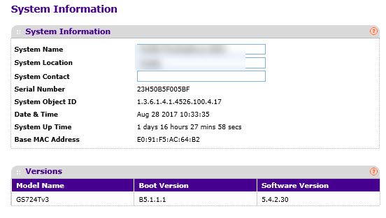

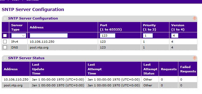

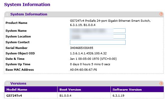

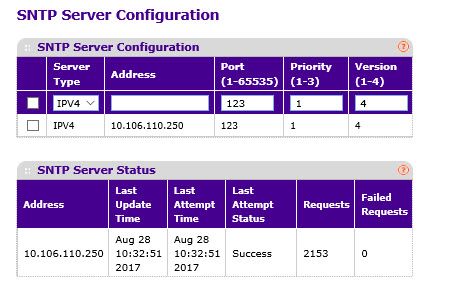

- r8899Aug 28, 2017Aspirant
Hi,
I found the same problem with SNTP, in GS724Tv4 (6.3.1.9).
There is no problem in GS724Tv3.
GS724Tv4:
GS724Tv4GS724Tv4
GS724Tv3
GS724Tv3GS724Tv3

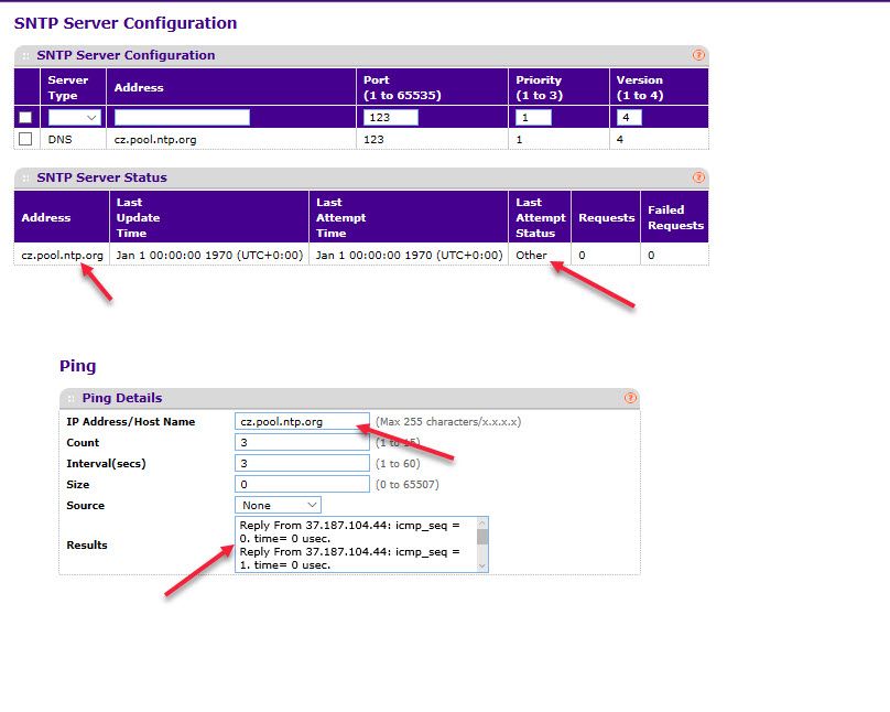

- DaneAAug 28, 2017NETGEAR Employee Retired
Is the 10.106.110.250 the default gateway? I found out that you are located in Czech Republic. Kindly check if you have a DNS configured on the GS724Tv4 switch and try to use cz.pool.ntp.org. Read page 48 of the GS724Tv4 software administration manual here on how to configure DNS.
How could be explained difference between GS724Tv3 GS724Tv4 (see pictures in my previous post)?
The same configuration of SNTP is working on GS724Tv3, but not working on GS724Tv4.
Of course, I have tried several DNS NTP servers (DNS server is set correctly on my GS724)
- r8899Aug 29, 2017Aspirant
No progress after 1 day:
DNS client in GS724 is working well.
