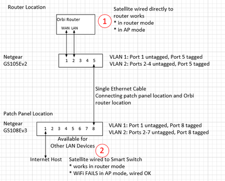

When a VLAN port on a switch is "tagged", that means that every packet going out that port will contain the 802.1Q Header Type/Size field immediately after the Source MAC address. When the packet goes into another managed switch, the VLAN tag remains part of the packet. When the packet exits that second switch:
- If that port is "tagged", then the VLAN tag remains in the packet.
- If that port is "untagged", then the VLAN tag is removed.
- When packets go through unmanaged switches, nothing is done to the payload. If there is a tag in the packet, it remains in the packet. If the tag has no packet, it just goes through the unmanaged switch "as is".
So, on switch 1 everything from the LAN port on the router is configured to be part of VLAN 4092. If the switch sends it out any of the untagged Ports, it has no VLAN tag. When it goes to switch 2, the 4092 tag goes with it. In switch 2, if the packet goes out any untagged port (like to a printer, computer, etc.) the tag is removed.
If the packet goes out the port leading to the satellite, we want to keep VLAN tag 4092 in the packet.
This is where I am confused. When observing the connection between Orbi router and satellite, I do not pick up any packets that contain VLAN tags. (no switches, just a simple Etherent cable.) Are they optional? i.e. the satellite is so smart it can recognize router packets with or without a VLAN tag?

If a switch port is configured to accept VLAN frames -and- is configured to take frames with the VLAN ID 4092 (the Orbi Guest VLAN, 1977 in my Swisscom guest network example) it will put these to the VLAN 4092 -internally-.
If a port is defined as [T]agged 4092 it will also forward these frames to the link making up a trunk.
If a port is configured for the PVID 4092, it will forward these VLAN ID 4092 frames after stripping the additional VLAN information.
With that same port configured for [U]tagged 4092, (together with the PVID 4092) that would make it an Access Port for that VLAN 4092.
All basic VLAN networking confusion cleared up a little bit now? These switches are wonderful machines!
It's like a water hose where water is flowing to, and there are some oil drops in it (not mixing into an emulsion) 8-)
A possible reason, why you don't pick up any tagged frames might be on your (Windows?) systems, where you are operating the Wireshark App. Drivers can have (and will have) an impact... This is what the Wireshark article I had referred before is about.

- schumakuApr 16, 2025Guru - Experienced User
Of course, correct!
This is why one has to configure the Ethernet port making up
- the physical between router and switch,
- between the switches,
- and from the other switch to the satellite as a trunk.
The main network will run untagged, while the other network(s) will run tagged.

Next step appears to be how to determine if I am able to capture and display Ethernet frames with VLAN tags. The only tagged link in the current experiment is between switch 1 and switch 2. So, tap that link and see if Wireshark displays VLAN tags. (The Wireshark documentation on VLAN is a bit vague and seems to indicate that Realtek adapters may ignore VLAN tags and some other adapters will strip them.)
Does this affect the basic design? The assumption was "two separate Layer 2 networks":
- One for the ISP-WAN port traffic. To be kept separate from the LAN traffic so that no local devices (including Orbi satellites) appear on the WAN port.
- One for devices on the LAN (including Orbi satellites).
Because the VLAN tags are needed only to keep the two networks separate as they pass through the single Ethernet cable and to identify which ports they use to enter and exit the two switches, the actual switch ports are untagged.

- What about the router to switch Port? If it is an untagged port with VLID set to 4092, then every frame will have a tag for 4095 added to it. Should it be set to a tagged port with a VLID of (???) for times the router sends out a packet without a tag?
- What about the port going to the satellite. It probably needs to be a tagged port?

I'll try to provide some ideas, so you can answer this question by yourself:
Where would you connect these "other devices" on an Orbi system?
- My answer (never having touched an Orbi consumer system in more than a decade): On the Orbi LAN port! These could be the Orbi router box LAN port, as well as the one of the Orbi satellite(s) LAN port - these are either bridged through the Orbi Mesh wireless backhaul, or direct connected by this network "cable" linking the Orbi satellite(s) LAN ports, and the Orbi router LAN port. At that point, the satellites are becoming pure wireless access ports (no magic at all!)
Would these other devices have to be VLAN aware?
- My answer: No, of course not!
See my network laboratory session below! I can't take away your learning curve on these basics. But please scratch and forget the basic port based config options from the Plus switches - it's about the advanced VLAN settings only-
It's a trunk port, carrying the LAN untagged, and the Guest network Tagged. Same as for connecting the Orbi router LAN port.

Well, the plot thickens! The Tap I had been using at first (Throwing Star with two Ethernet-USB adapters) never showed anything with a VLAN tag on the Ethernet link between RBR750 router and RBS750 satellite. I just now installed the other Tap with a different Ethernet-USB adapter on that cable link (no switches) and it does show two kinds of packets:
- Between the router LAN port and satellite LAN port are ordinary (untagged) Ethernet frames.
- Between the router WiFi MAC address and the satellite WiFi MAC address are frames with VLAN tag 4093.
This may be why "it ain't gonna work."
When the router/satellite transmit Ethernet frames with and without VLAN tags, dumb old Ethernet switches are totally oblivious. They care only about their internal routing tables. "which port do I transmit this packet out to reach this MAC address?"
Now I have to investigate what "managed" switches from Netgear and TP-Link do when some packets appear on a port with VLAN tag and some appear without a VLAN tag. The cool process would be to simply shove another VLAN tag into the packet when it comes into the managed switch. Let that VLAN direct the flow through the switches, and remove that VLAN tag when the packet emerges out the other switch (leaving the original VLAN tag intact for the satellite to deal with).
And, how did the router know where the MAC address for the Satellite WiFi is? With WiFi, it's is radio waves. With Ethernet, the router has to pick one of the Ethernet LAN ports. Have to go back and start the capture before connecting the Ethernet cable.

Time to add the VLAN 4093 plus define the [T]agged 4093 on the trunk links connecting (I guess now something for some internal comms on these Orbis), and on the trunk where you connect your switches - so you have the plain VLAN 1 plus two tagged VLANs 4092 (guest) and 4093 (Orbi internal use?)
That's' exactly what an Ethernet bridge does!

After discovering that a Wireshark capture on Windows 11 laptop revealed the RBR750 producing packets with VLAN tag 4093 and the capture on a Windows 11 desktop did not, my assumption was that the Ethernet-USB adapters being used on the desktop were the cause. Amazon delivered new Ethernet-USB adapters to match the one that is working on the laptop, and (damn) they, also, did not capture any VLAN packets! It now appears that the ASIX driver on the desktop is at a version from 2012 and the version on the laptop is from 2024. Only the new driver has the "advanced" feature to enable VLAN capture.
Both the laptop and desktop were purchased within the past two years and are both running the most current version of Windows 11. Grrrrrr.
Eventually this will all get resolved. What appears to have been determined thus far is that:
- The 750 product uses VLAN 4093 to communicate information over the Ethernet link about the network configuration. (topology)
- This is using ieee1905 protocol. https://en.wikipedia.org/wiki/IEEE_1905
- When a device connects to the primary WiFi network on an RBS750, it uses regular (untagged) Ethernet packets.
- When a device connects to the Guest WiFi on an RBS750 satellite, it uses VLAN 4093 for communication to the router over the Ethernet backhaul link. Perhaps this is linked to the use of a different IP subnet for Guest WiFi in the AX products? (perhaps not?)
Potential "to do item": once I get the damn Ethernet adapter issue worked out, it is worth figuring out how the original WiFi5 Orbi product handles Ethernet backhaul? There is the obvious intellectual curiosity. But the WiFi5 products are End of Life. Maybe how they did things is not particularly helpful.

I tried both 4092 and 4093 IDs at the same time Tagged on ALL Ports with the managed switch and Guest Network is not working for devices connected behind the RBS thats ethernet connected to same switch with the RBR.
