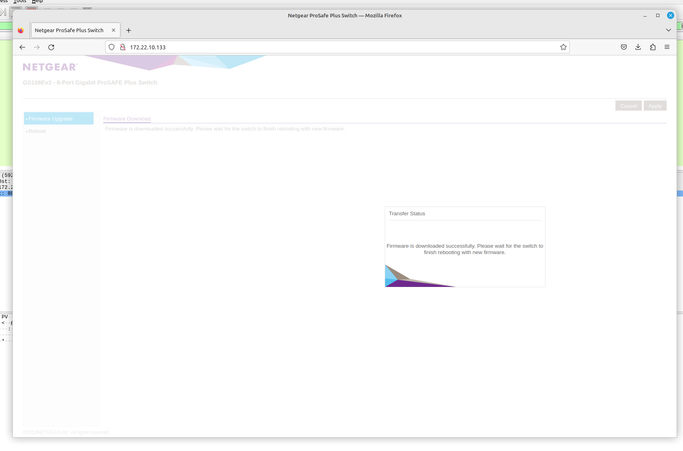

I just tried taking the firmware back to 2.06.17.
Screen just sat there for more than 10 minutes as per the attached screenshot.
Refreshed browser screen and showed it was still on 2.06.24.
Rebooted and still on 2.06.24.
I am connected directly to the switch.

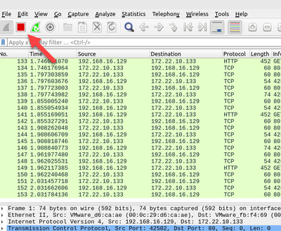

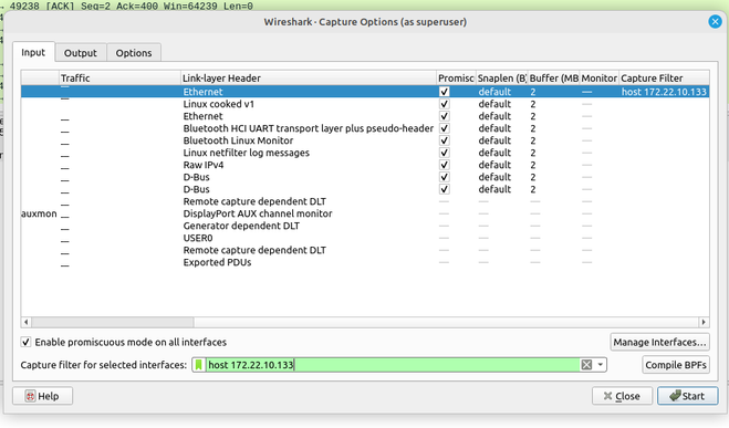

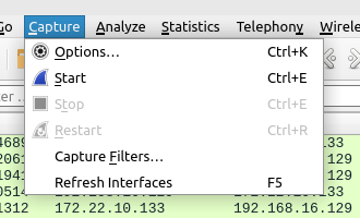

Is there a possibility that you can provide me with the Wireshark capture? Now, you can filter out any traffic, that is not send/received from the switch itself, to do this, you do the following:
- Install Wireshark (sudo apt install wireshark)
- Start Wireshark (sudo wireshark)
- Go to Capture -> and select Options
- In options, select your network card, and then in filter, enter host xxx.xxx.xxx.xxx, replace xxx with your switch's IP address, and then press Start
- Then open the GUI of the switch, enter FW loader mode, and perform the steps.
- Once it's replicated, you can stop the capture
- If you can then save this capture, and forward it to me, I will send a PM with a sharepoint link, where the file can be uploaded.
