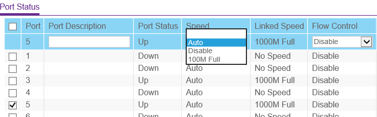

 We own 3 Netgear MGig switches XS724EM / M4200-10MG-POE+ and MS510TXPP with any of these Switches if we attempt to plug in a Cisco Meraki MR53E AP (Supports MGig 2.5) the switch will show a 2.5G 'up" but it can't connect to the Network...  Meraki has suggested we manually force the switches to 1Gbps while they research the issue  (if we plug the MR53E into a 1G on the MS510TXPP it works with no issues - if we set one of the 2.5/5G ports to 1G it won't connect)
for the XS724EM - under "system management" "port status" select a port... under "Speed" the only settings are Auto, Disable or 100M Full - is there any way to manually force 1G on ports?
for the M4200-10MG-POE+ under "switching" "ports" "port configuration" under "speed" - no options if we just typing "1000" does that set the port to 1G?    Any ideas?

    For the XS724EM,speed contain Auto/Disable/100M, cannot force 1G speed. Switch will auto negotiate speed for 1000M/2.5G.
    If connect M4200-10MG-POE+(2.5G port) to XS724EM, the speed will link up with 2.5G.
    If connect M4200-10MG-POE+(5G port) to XS724EM, the speed will link up with 5G.

      The thing is that the IEEE standards does not allow to set a fixed speed - certainly on 1G, and most likely on the higher rates of 2.5G/5G/10G/ff, too. Even if "fixing" a port to 1G (ie. on a XS748T/XS728T), there is an auto negotiation mandatory - it's just that the port does only announce the 1G capability, and nothing else.
      Indeed, Netgear has a little inconsistency in the UI controls over various switch model lines, I've just dropped an email to the product managers. Some other models indeed don't have a UI (or CLI) control to "fix" a GbE port to 1G.

        Don't be misguided by the classic speed setting experience we had in networking up to 100BASE-T - there is fixing speed possible. Starting from 1000BASE-T, auto negotiation for speed and duplex is mandatory. That's the logic implemented on ie. the XS724EM and most Smart Managed Pro switches - either the ability to select 100M or auto.
        Can only speak for the MS510TX extensively compatibility tested on the MultiGig ports where any slower speeds can be set, ie. on a 10 Gb port to 5/2.5/1/100M - except of the 100M, the config does change the maximum speed announced with the auto negotiation. And this worked during early deployment tests and still works accordingly with various MultiGig equipment I had at hand back then.
        Netgear promised to review and harmonize the behaviour and the Web UI in a customer friendly way. Adding the 1G Full Duplex setting to the current XS and MX switch models is intended (following NX-OX btw.), too. Of course, such a change does take time, and is unlikely done in a rush.
