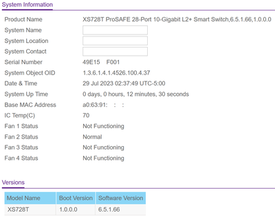

I am using an xs728t in a homelab environment (access to plenty of climate controlled air). In order to mitigate the INCREDIBLY loud fan noise from this thing, I went looking online for fan replacement options and found this post. I bought both the arctic 6k and 15k fans and appropriately made the pin modifications in the OP. I started with one of the 15k models and noticed that they didn't want to spin up at all. My best guess is that they didn't work because of requiring a higher starting voltage than the switch is giving (which of course is the problem with the noctua replacements) - I tried the 6k versions and they spin up just fine. they don't move a whole lot of air compared to the stock delta fans, but they still don't spin up to full blast while managing to keep the switch at a still pretty toasty but I think ok ~70c (please let me know if i'm wrong), HOWEVER, the switch's fan error light is on and in the web ui, it tells me that each of the fans is intermittently not functioning (each fan will say not functioning at some time or another and eventually say that it's normal again).
1. Is 70c an ok temp for these switches (or am I slowly killing my switch doing this)?
2. is there a more appropriate fan replacement that is quiet, moves adequate air, and doesn't cause the switch to say that the fan isn't functioning?

Here is the output from the web UI illustrating my previous post. Please note that the fan statuses change seemingly at random with every refresh of the page. sometimes they all show "normal", sometimes all "not functioning" and typically a mix of the two.
Also of note, the stock delta fans have always worked and have never thrown an error. I'm also not sure exactly what's being detected as far as the status is concerned (my best guess is that it varies the voltage and that it sends back a tachometer signal and the fan isn't spinning fast enough for the software threshold?)
I'm not sure if I should just use it the way I have it and call it fine, or if I should be worried and seeking of other options.
