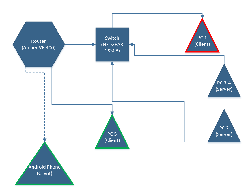

GS308 NAT Loopback
I am having a NAT Loopback issue on my network, any PC connected behind my GS308v3 switch will not connect using my public IP to my servers (running on the same network also behind the switch). I...
- May 17, 2022
Welcome to the community! 🙂
The GS308v3 does not support NAT Loopback. Be informed that the GS308v3 is a pass-through, unmanaged switch wherein its main purpose is to extend the LAN network. It gives you additional ethernet ports to connect more devices such as PCs, network printers, etc.
