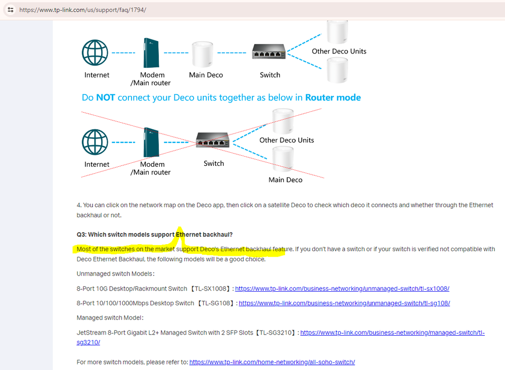

    Can you check if setting up the TP link deco wired backhaul will also work with other unmanaged switch. What are the status of the leds on the switchport when the Deco device is connected? It will be best to open a support case so Netgear can investigate this further. Or more likely a limitation on Deco setting up a wired backhaul since it requires the satellite to be connected directly to the Main Deco lan port?
    https://www.tp-link.com/us/support/faq/1794/
