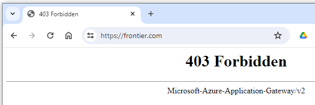

Unfortunately, Frontier does block any access to their knowledge behind some application layer gateway - impossible organization for people which try to assist. https://frontier.com/resources/fiber-optic-installation does end on a 403 Forbidden .... simply ridiculous when attempting to connect from Switzerland - Kids at work there?

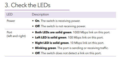

The only indication the undefined Netgear 5 port switch have typically available re port link LEDs. Start from https://www.netgear.com/support/ and enter the product name or description, based on your switch.
A typical recent model is the GS105v5. https://www.netgear.com/support/product/gs105v5#docs and the 5-Port and 8-Port Gigabit Ethernet Unmanaged Switch models GS105v5 and GS108v4 Installation Guide does show the Check the LEDs
