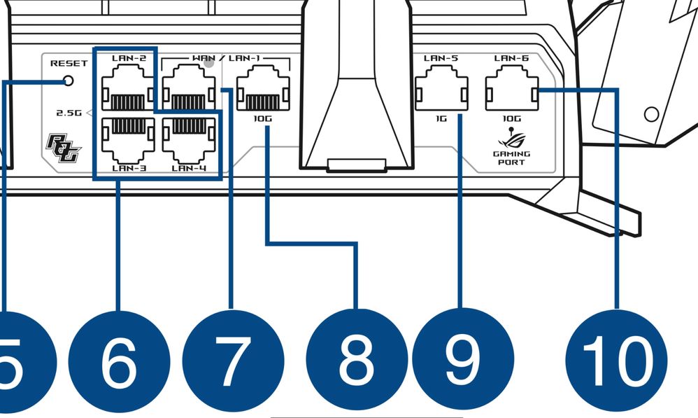

Now a last question something crazy. With a router GT - AC5300 and a Qnap TVS-672XT, in this last one I used LAN port 1 with 10G and LAN port 2 and in the router the assigned ports for this and worked perfectly.
I changed the router to GT BE-98 Pro as can be seen and in the manual it says to use LAN port 6 of 10G and port 5 of 1G and not work, then the router has other configuration to use lan port 6 of 10G and Lan port 1 of 10G. However, I'm using the Switcher in mention to connect the router from that LAN port 1, the Orbi Kit and computers. As I don't want to remove the Switcher to other port with lower speed as it will kill the Orbi, if I connect to the Switcher the second port of the Qnap and to the LAN port 1 of the Qnap to the LAN port 6 of the Router ASUS directly? In other words:
GT-BE98 Pro Router
LAN 6 (10G) -----> QNAP Port 1
LAN 1 (10G) -----> SwitcherSwitcher
-> Orbi Kit
-> Computers
-> QNAP Port 2It could supply the link aggregation effect having all that devices in teh same switchers?
Thank you
This is the diagram of the router where can be seen only two ports I have 2 Ports 10G, 1 and 6 and 1 will be connected to Switcher and 6 to QNAP.
