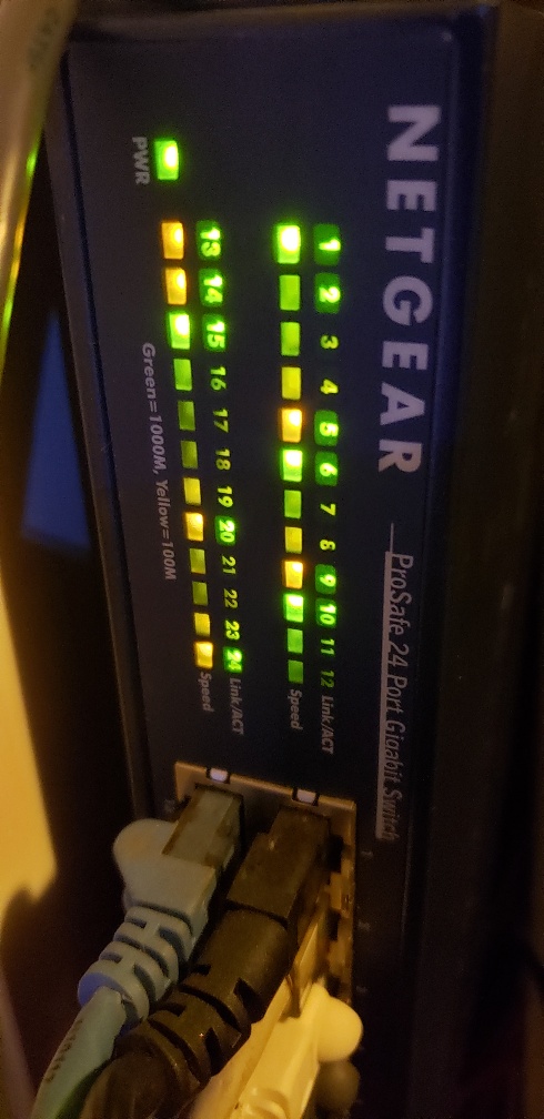

The fan in the JGS524v1 is making excessive noise.
I see much of Netgear's offerings have Lifetime warranties. Does that include the v1 of the JGS524?
The fan is making excessive noise. Considering O bought it when it was on sale for over $250, I suspect it's a v1 of the unit. I can give a good photo or two of the front panel. My question is does anyone know what fan I can get to replace it? Is it wired to the board directly or are there wires or plugs that make it solder less? Is it possible this probably 15 year old model is serviceable under a lifetime warranty? Cannot find a serial number on the front or back panels. It's rack mounted to a wall so if its coming down its to replace it or have it serviced. Now the serious question is there any model in their product line that is seriously better? I'm close to using all 24 ports so don't think I need to go to 48. I see them on Amazon for around $100. So guess this is part 4 of the question. Is purchasing through Amazon a mistake for these products? Does it effect warranty?
Thank you all for any potential support for this old network switch.
  • For anyone faced with a similar problem with the v1 of the JGS524 Prosafe Switch, here is the solution. A replacement fan is available from DigiKey and others. It is a fan axial 40x20.mm 5VDC with 2 wires. Mfg Part # EFB0405LD, which is also DigiKey's Part#. It's from Delta Electronics. The two bare wires need the plug from the original. Carefully pull the leads out of the bad fan, clip off the end with the plug and tin each lead halves, solder together with your replacement fan using heat shrink tubing to protect the solder joints. Be sure to mind polarity as you want the fan blowing in the same direction! This fan is plugged into the main board and bolted to the chassis so be sure to save all the original bolts! Warning the chassis bolts are small Philip's heads and very tiny so don't lose them. Push the new leads back into the original plug to seat, again being careful to mind the original polarity. The plug is keyed so it can only go back in to the chassis one way. Now lets hope you get another 15 years of useful life out of your otherwise reliable JGS524V1. Now that I have a JGS524V2, which has a lifetime warranty, my original JGS524V1 will be plugged in to be used should the V2 unit ever need a warranty replacement should Netgear not cross ship a replacement product. Better to have a 2 hour downtime to 2 weeks, right? I consider this reply to be a solution to the problem I reported. DaneA gave me the answers to the other questions but I had to find an answer to my original problem of is the fan plugged in or soldered (plugged) and are spare fans parts available, (they are from other sources at quite reasonable prices making the repair viable and cost effective).
    For me, since the fan of your JGS524v1 is making an excessive noise, I advise you to purchase a new 24-port unmanaged switch.  I recommend you the JGS524v2.
    If ever you insist on just replacing the fan, I will leave this forum post open to new replies so that if ever other community members have experienced replacing the fan on their JGS524v1, they could post their suggestion here on this forum thread.

    • Guzzialfa's avatar
      Guzzialfa
      Tutor
      Thanks DaneA. I do have updates to share much of which I found on my own. I have purchased and received a JGS524 v2.0. Once I had it installed, I was able to take my v1.0 switch apart and found out the fan is indeed a plug and play device. I ordered the identical model fan from DigiKey for around $12+shipping. Since its bolted to the chassis, I didn't want to take a chance with alternate fans. Now I will have a spare switch that has served me well for 15 years. The fanless design of the 2.0 model with the increased buffers and lifetime warranty means a lot but being without a switch that serves so many devices wasn't something I wanted to do with out. Not for a $12 part that's for sure. I did get it from Amazon and promptly registered it with NetGear. The Lifetime warranty was a big factor in purchasing it over other brands from Cisco, Linksys and others. The support I couldn't get on a Sunday night with a 95 minute phone call turned me off a lot but the reliability of the product helped me make the decision. Thanks for the responses. It helps knowing I made the right decision anyhow.
        This completes the Q and A of all questions asked. Technician Heal Thy Own Equipment. DaneA, thanks for responding to all the other parts of my question.
