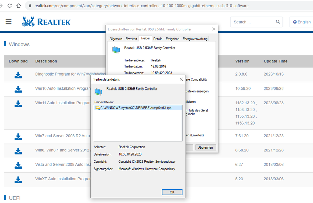

Adenmara wrote:
2. 2.5 Gb: Realtek 8125B 2.5G LAN controller, Driver: 10.59.425.2022
About the similar version operating on my Win 10 64bit device, connected direct to an XS505M desktop switch as an intermediate network switch, linking to my main LAN.
