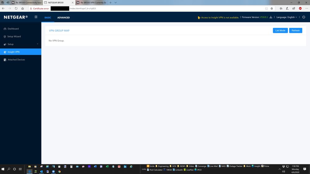

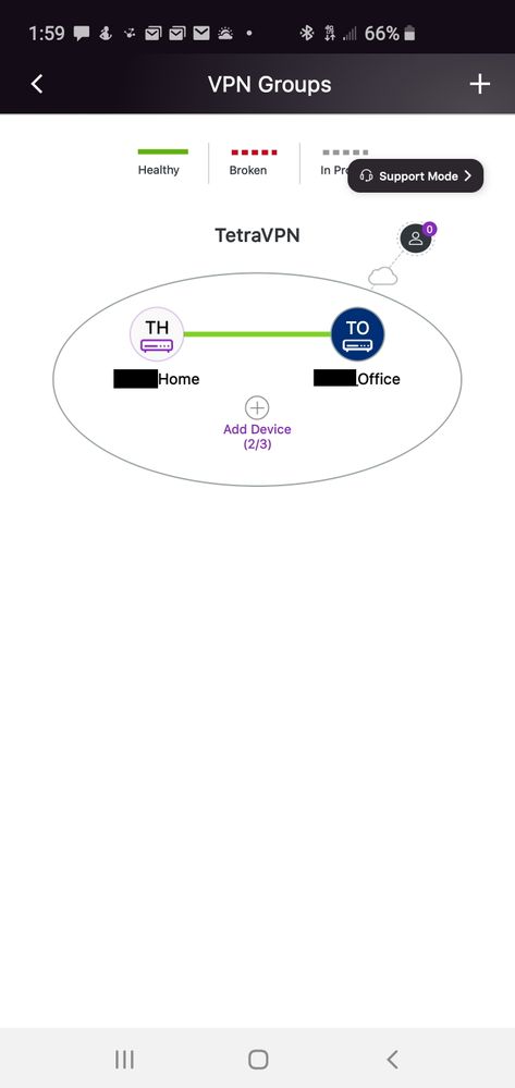

- tetrawestApr 06, 2020Apprentice
We have been putting up with the for 6 months. What was the problem and the fix?
Also, the Insight VPN is not "Fully Fixed", or at least the firmware still has issues.
My Insight VPN is up. I can use the Insight App and the Insight Webpage to look at the VPN service. If I log into the Router, it says the VPN is not avaiable and there is no VPN group. It is connected and working, yet the Router reports it doesn't exist. I'll post picture later.
- Retired_MemberApr 06, 2020After dealing with the VPN issues for over a year we have been forced to go to other firewalls. These BR500s have potential but we cannot have constant downtime with the tunnels between offices. The generic answers of reboot firewall or manually connect and change the VPN proxy is not a solution - it works maybe 1 out of 10 attempts.
We wasted so much $ on these devices between constant downtime for our branch offices, remote users, cost of devices, subscription costs, and IT time in babysitting these. These devices and the Insight VPN solutions are not ready for production use - Beta at best.
Best of luck to everyone with these going forward. - tetrawestApr 06, 2020Apprentice
Router Insight VPN pageLocal application
